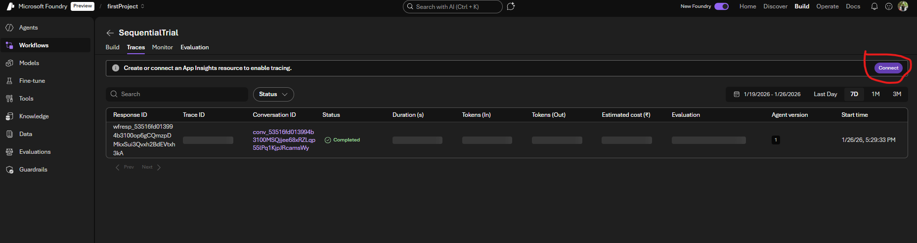

    Microsoft Foundry uses Application Insights (OpenTelemetry) for observability and tracing. In the Foundry portal:
    1. Go to your Agent/workflow, Trace Tab, and use the Connect button (As highlighted in the image below)
    2. You could connect to an existing or new Application Insight for the Agents/workflow
    3. Once connected, you can view traces in Foundry (Trace ID, timeline, status, error details).
