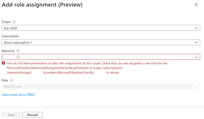

Hello,
I have a Azure Function that has managed identity. I would like this identity to be able to get secrets from Azure Vault. My admin is trying to set the necessary role assignment, however he is getting an error:
You do not have permissions to add role assignments at this scope. Check that you are assigned a role that has the Microsoft.Authorization/roleAssignments/write permission at scope /subscriptions/XXXXXXXX-XXXX-XXXX-XXXX-XXXXXXXXX/resourceGroups/XXXXXX/providers/Microsoft.KeyVault/vaults/XXXXXX or above.
What privilege the admin should have to able to do it? Currently admin has the following roles:
  • Privileged role administrator
  • Cloud application administrator
  • Application administrator
Thanks,
MT

    Hello @MT ,
    Thanks for reaching out.
    Looking at the error, the MI(Managed Identity) doesn't have access to perform the action 'Microsoft.Authorization/roleAssignments/write'. Since the MI(Managed Identity) is assigned with Privileged role administrator, Cloud application administrator, Application administrator which is part of Azure AD roles and these roles are limited within Azure AD directory so instead we need to assign Azure RBAC roles (IAM) to manage Azure resources like Key Vault.
    To understand different between Azure AD roles and RBAC roles, refer : https://learn.microsoft.com/en-us/azure/role-based-access-control/rbac-and-directory-admin-roles#how-the-roles-are-related
    I would request you to check, the Managed Identity is assigned with a RBAC role (Not Azure AD role) that has the Microsoft.Authorization/roleAssignments/write permission such as Owner or User Access Administrator at the scope you are trying to assign the role.
    To resolve the issue, assign the MI(Managed Identity) with Owner/User Access Administrator RBAC role or create a custom role with Microsoft.Authorization/roleAssignments/write permission and assign this role to the Managed Identity.
    Reference: https://learn.microsoft.com/en-us/azure/role-based-access-control/troubleshooting#problems-with-azure-role-assignments

    Finally, assign the Custom Contributor RBAC role to the MI(Managed Identity). You should no longer get above error for role assignments and should return StatusCode=201 (Created).
