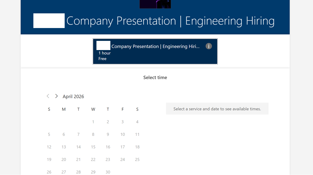

As part of our recruitment process, the initial step involves sharing a presentation link with candidates. This link is intended to allow candidates to book a presentation slot according to both the scheduled sessions and their individual availability. The goal is to provide a seamless experience where candidates can view all available slots and select the one that best suits them.
While the link has already been shared with candidates, we have received feedback that they are currently unable to book their preferred slots. The system was displaying only a single available slot, which does not reflect the full schedule but now it is displaying no slots are available. For reference, the presentation is planned to be conducted three times per week. However, the current booking system does not show all available sessions, preventing candidates from selecting a slot directly.

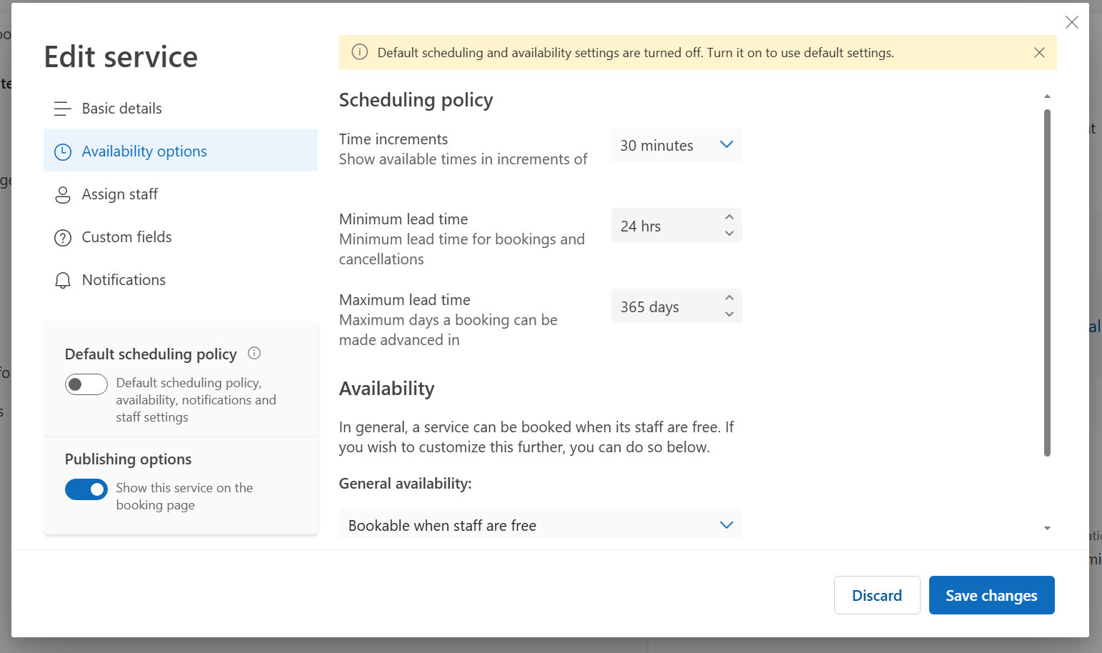

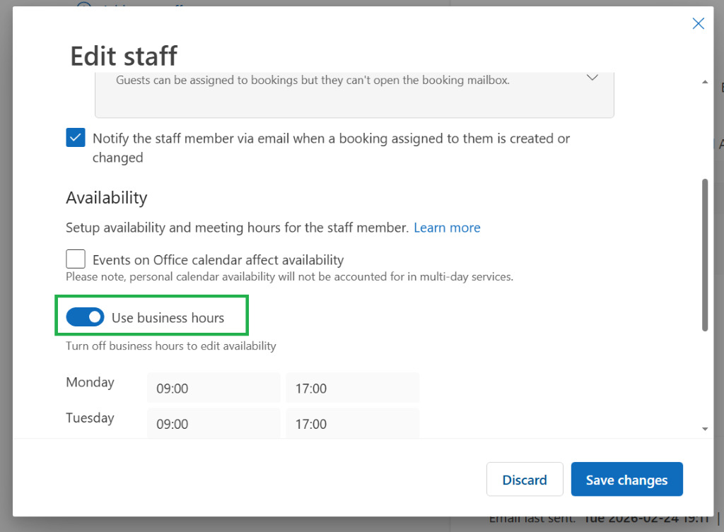

    • Is the staff availability for the service set to “Use business hours”, or is a custom availability configured?  User's image
    • Are the assigned staff members marked as available during the intended presentation times?
    • And also could you check the lead time ? Adjusting the minimum lead time for the service to 1 hour and see whether that improves the behavior.  User's image
