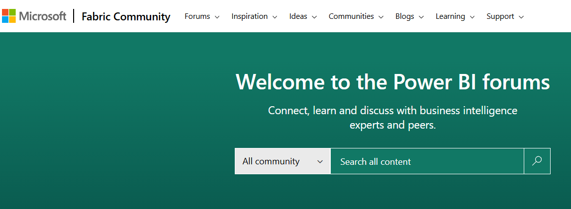

    To ensure you receive the most logical and effective resolution, I strongly recommend sharing this concern within both the Microsoft Power BI Forum and the Microsoft Power Platform Community
    User's image User's image
