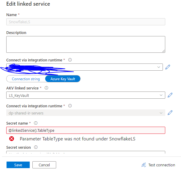

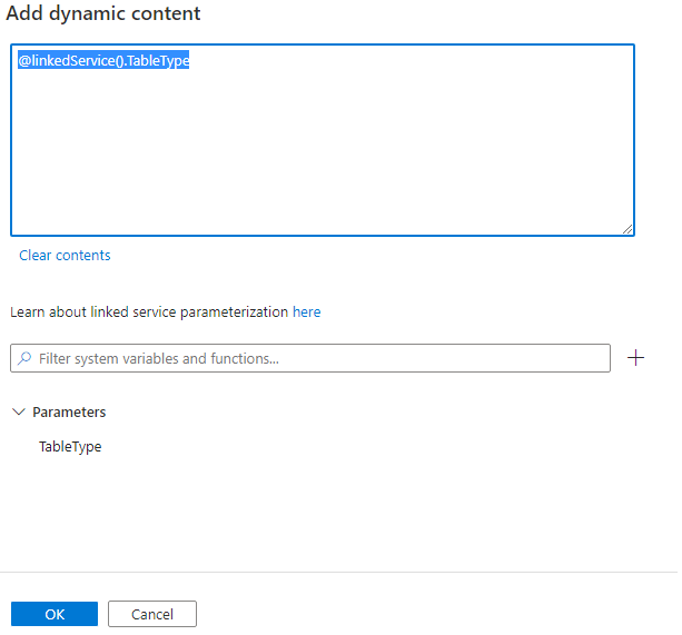

I am trying to parametrise snowflake linkedservice credentials. I am trying to read from keyvault. Based on dbname,i need fetch different secrets from keyvaul140551-capture.pngt .I am getting error. I am not sure how to do it.

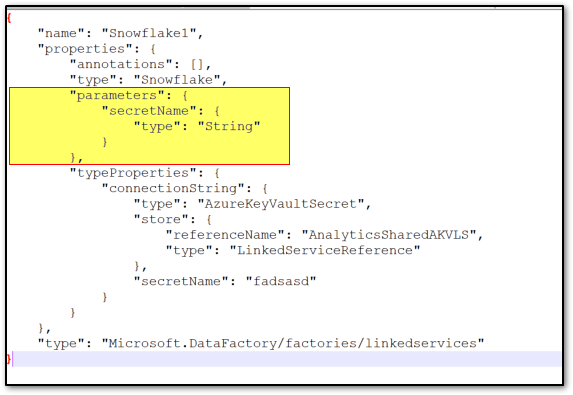

    The error you are receiving is because you might not have declared the TableType parameter in your linked service.
    In-order to parameterize your Snowflake Linked service, you will have to first create a snowflake linked service and then once after it is created, click on {} to open the JSON payload of the linked service. Then add parameters section to your json payload to declare a parameter for secretName as shown in below code. This should allow you to create a parameterized AKV secretName and you will have to pass the secret name based on the respective database name.
    I have attached the JSON payload sample for your reference here : 140823-snowflakelinkedserviceparameterized.txt
    You can use this JSON payload and add more parameters as needed in the similar way.

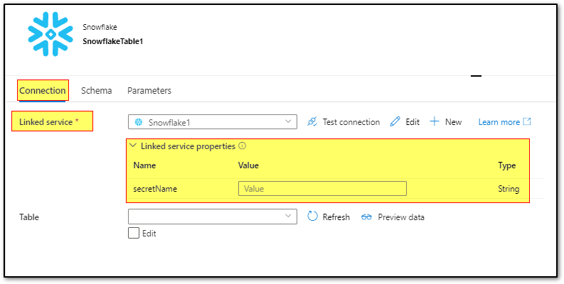

    Once you have added parameters, when you use this parameterized linked service in a dataset, then you will see this parameter in the linked service properties section as below:
