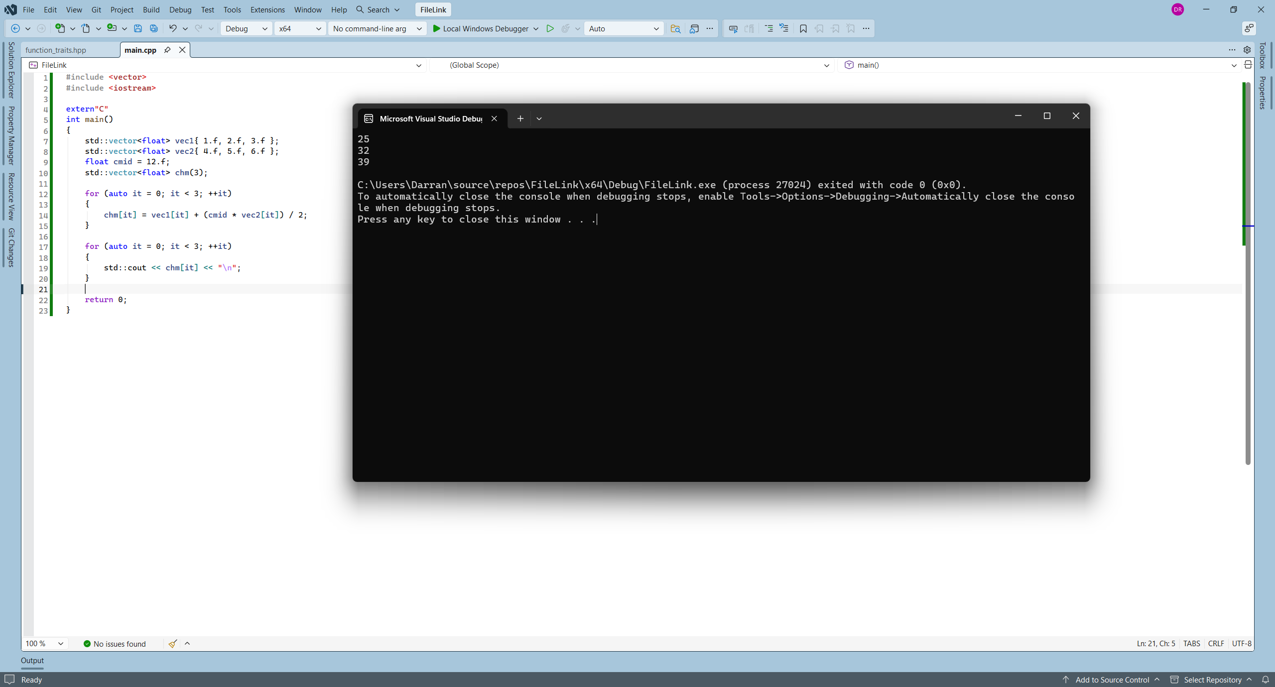

  1. Nancy Vo (WICLOUD CORPORATION) 4,605 Reputation points Microsoft External Staff Moderator
    2026-05-27T06:16:09.14+00:00
    Hello @Sid Kraft ,
    Thanks for your question.
    Since CHMID1, CHMID2, CHMID3 were declared with no size, no slots exist to store data. Furthermore, CHTMP1, CHTMP2, CHTMP3 were declared inside do{}, they die when loop ends.
    You can refer to following code example:
    #include <vector>
    int main() {
        std::vector<float> PT1 = {1.0f, 2.0f, 3.0f};
        std::vector<float> PT2 = {1.0f, 2.0f, 3.0f};
        std::vector<float> PT3 = {1.0f, 2.0f, 3.0f};
        std::vector<float> VEC1 = {1.0f, 2.0f, 3.0f};
        std::vector<float> VEC2 = {1.0f, 2.0f, 3.0f};
        std::vector<float> VEC3 = {1.0f, 2.0f, 3.0f};
        float CHORD1 = 1.0f, CHORD2 = 1.0f, CHORD3 = 1.0f;
        std::vector<float> CHMID1(3);
        std::vector<float> CHMID2(3);
        std::vector<float> CHMID3(3);
        float CHTMP1 = 0.0f;
        float CHTMP2 = 0.0f;
        float CHTMP3 = 0.0f;
        int I = 0;
        do
            float CH1 = PT1[I];
            float CH2 = PT2[I];
            float CH3 = PT3[I];
            float VC1 = VEC1[I];
            float VC2 = VEC2[I];
            float VC3 = VEC3[I];
            CHTMP1 = CH1 + (CHORD1 * VC1) / 2.0f;
            CHTMP2 = CH2 + (CHORD2 * VC2) / 2.0f;
            CHTMP3 = CH3 + (CHORD3 * VC3) / 2.0f;
            CHMID1[I] = CHTMP1;
            CHMID2[I] = CHTMP2;
            CHMID3[I] = CHTMP3;
            ++I;
        } while(I <= 2);
        return 0;
    image (15)
    I hope this addresses your question. If this response was helpful, please consider following the guidance to provide feedback.
