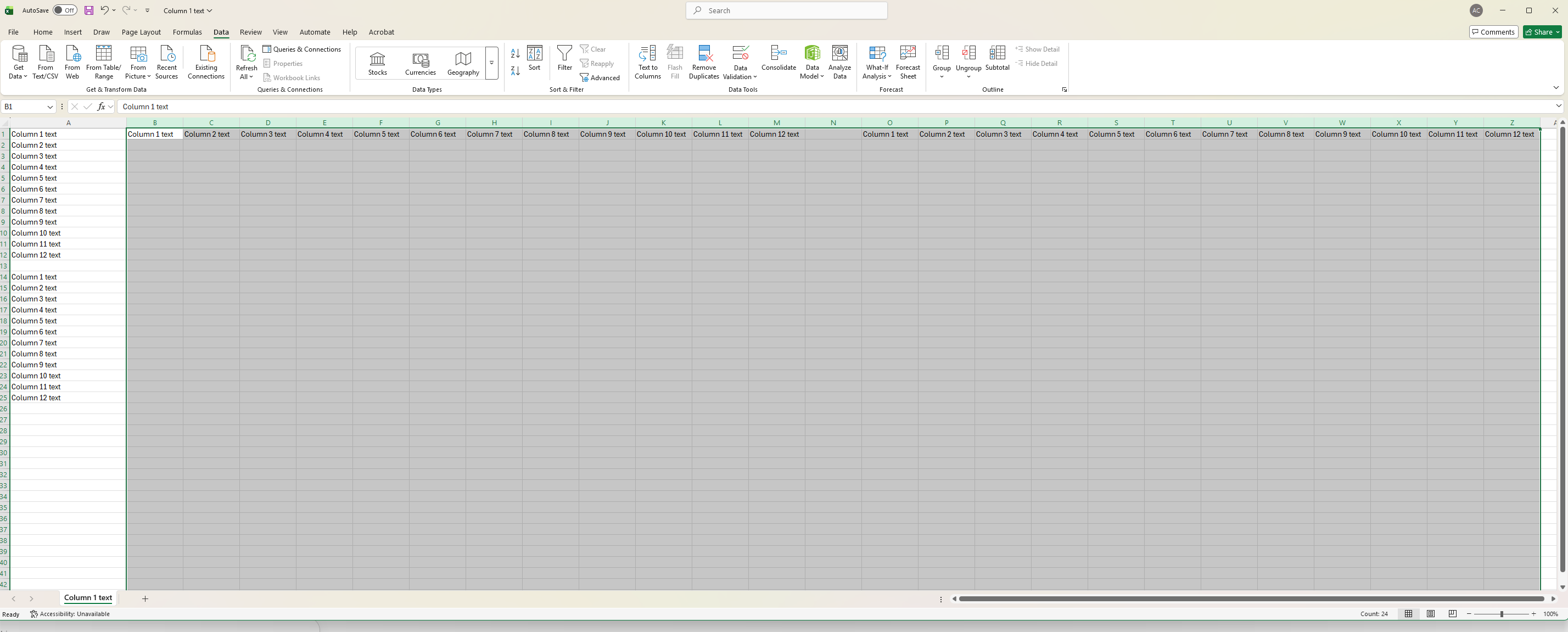

The scenario:Screenshot 2026-06-12 111932
Column A represents 2 lines (in this test) from a 3rd-party program - hence, two "data blocks" for lack of a better term. For each line / block of data, I want to create a separate row. When I did a copy on the 2 line block and did a paste special => transpose, it did make a column for each line of data - but it put the second line of data on that same first line. I'd like, if possible, to have each line / block from column A "transposed" into a separate line with 12 columns. I know - why not copy / paste each line and transpose, rinse and repeat? Because in my case, I have hundreds - if not thousands - of lines to do, and it's not feasible to copy / paste / transpose data block by data block.
Does anyone know if my scenario is doable?

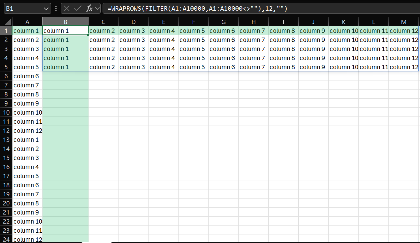

    I appreciate the clear explanation of your issue. I understand that you have repeating blocks of 12 rows in Column A, and you would like to transpose each block into one row with 12 columns. From my research, there are several possible ways to achieve this in Excel. Below are two approaches that may help, depending on your Excel version and whether you prefer using a formula or VBA.
    Please try the following options:
    1.Use a modern Excel formula
    If you are using Microsoft 365 Excel and have access to the WRAPROWS function, you can use this formula In cell B1(or wherever you want the output):
    =WRAPROWS(FILTER(A1:A10000,A1:A10000<>""),12,"")
    This formula takes all non-blank values from Column A and wraps them into rows of 12 columns.
    Notes:
    • Enter the formula only in B1.
    • Do not copy it down.
    • Make sure the output area, such as B1:M1000, is empty before entering the formula; otherwise, Excel may return a #SPILL! error.
    User's image If WRAPROWS is not available in your Excel version, you can try this alternative formula instead:
    =LET(data,FILTER(A1:A10000,A1:A10000<>""),n,12,numBlocks,QUOTIENT(ROWS(data),n),INDEX(data,SEQUENCE(numBlocks,,0)*n+SEQUENCE(,n)))
