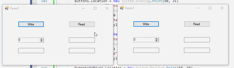

  4. Castorix31 90,686 Reputation points
    2021-11-06T15:28:33.957+00:00
    Another simple sample with MMF to share a structure between several instances of an app :
