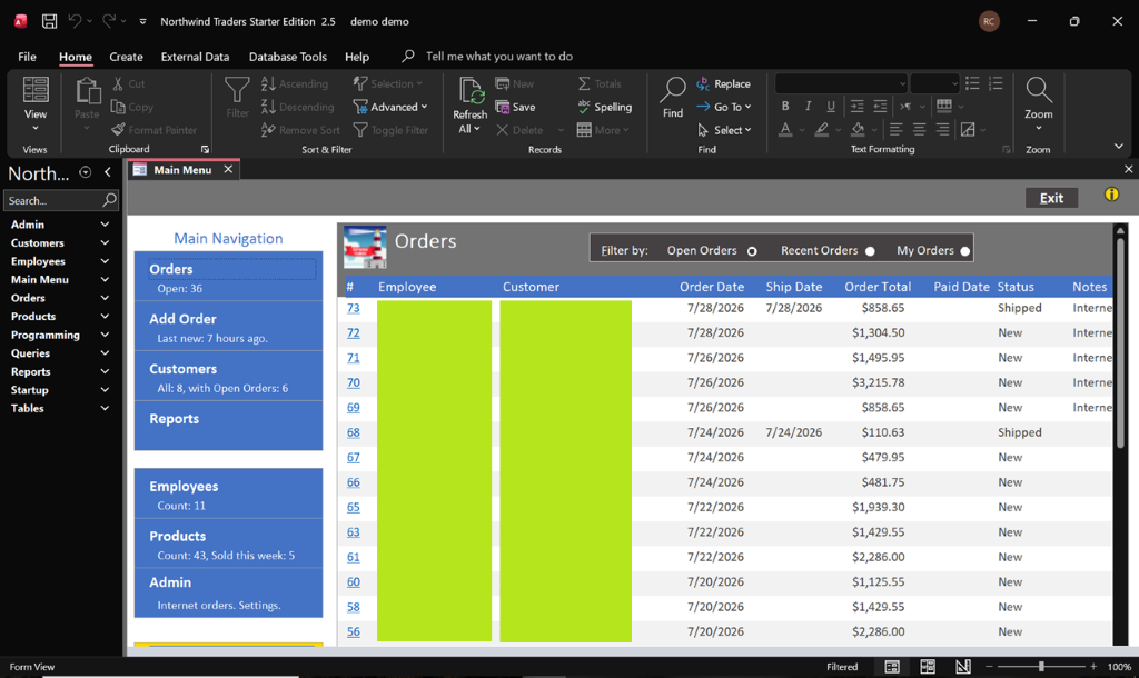

    However, I also tested opening the template directly from Microsoft Access. In my test, Access did take some time after selecting Enable Content, but the template eventually opened successfully. You can see the screenshot below for reference:
    • Because of that, please try opening the template directly from Access again and allow it a few minutes to finish loading after selecting Enable Content.
    • Also, please confirm that your Access version is supported. This template applies to: Access for Microsoft 365; Access 2024; Access 2021; Access 2019; Access 2016
