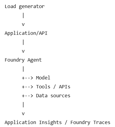

    The useful pattern is:

    Foundry can then provide the per-request traces needed to determine where latency occurs. Microsoft recommends connecting Application Insights to the Foundry project; server-side tracing is then available for agents hosted in Foundry.
    Also remember that load testing an agent isn't exactly the same as testing a normal REST API. A single user request may result in several model calls, retrievals, and tool executions, so model quotas/rate limits and downstream dependencies can become the bottleneck before your application endpoint does.
