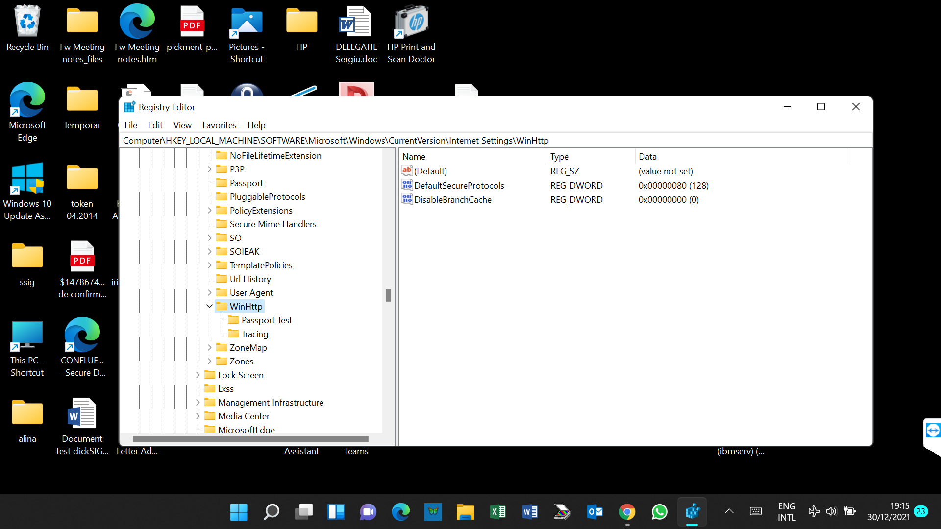

    1. Turn on TLS 1.0 on the local windows 11 system by adding a registry key under
      HKEY_LOCAL_MACHINE\SOFTWARE\Microsoft\Windows\CurrentVersion\Internet Settings\WinHttp
      DWORD named DefaultSecureProtocols
      with the key value of 00000080
      Save and restart
      Reconnect, the error should be gone and should work offsite
