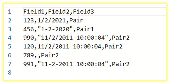

    My understanding is that the issue is don't appear when you had the "Quote All" is disabled.
    This is because - when you pass the value "" (this is the blank date value when it gets quotes) it gets translated/parsed as '' - gets an error as this is not a valid date time string.
    Hence you see tthis piece of string '' in your error text.
    Now, when you unquote - the above behavior is not observed because - the D365 is able to handle a blank value.

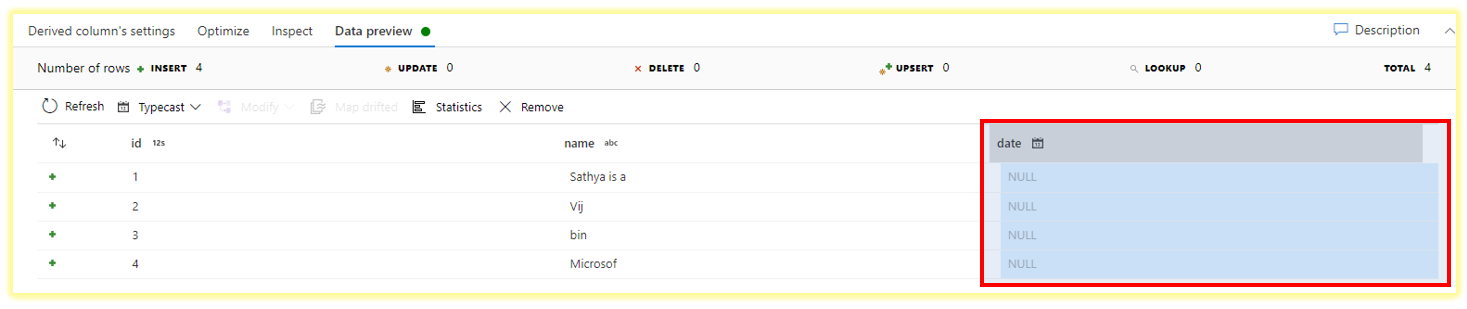

    I was able to return null using the below expression :
    toDate(null())
    Output :

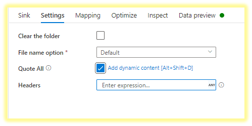

    How do I ensure text values are quoted and commas are escaped properly if I don't tick the "quote all" option the outputted CSV is not always quoted?
    If my understanding correct, you wanted to know whether the Output CSV - contained quotes. The texts in the output are not quoted. When you have unchecked the above option.

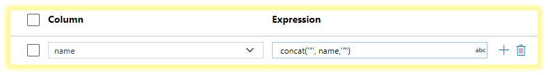

    I used the below expression in the Derived column to quote only the text fields
    Here name is a text field.
    Also you'd need to remove the quote character and set no escape character at the dataset property.
    Output :

    Ok I asked this question weeks ago and havent had a solid answer below is a summary of what I have found to work and perhaps someone can tell me if there is a better way of approach it. The first reply was very useful in terms of giving me a clue about the issue but didnt explain how to handle type conversion.
    Copy Activity
    In a nutshell for a Copy Activity when the source dataset is processing a text quoted source (e.g. CSV) and the non-text field types are surrounded with quotes this will cause type conversion errors. For example “19/10/21” would generate the following error in the copy activity even if a format of dd/MM/yy was specified as a format in the copy activity:
    ErrorCode=TypeConversionFailure,Exception occurred when converting value '19/10/21' for column name 'xxx_yourdate' from type 'String' (precision:, scale:) to type 'DateTime' (precision:, scale:). Additional info: String was not recognized as a valid DateTime.
    The Sink type doesn’t matter as this error is raised as part of ADF conversion of datasets to its interim types before the sink operation. To help avoid type conversion errors ensure that all non-text data type fields (e.g. Date, Integer, Decimal) are not text-quoted. In addition a clear plan for handling non-text data types and formats needs to be in place. The Copy Activity has some very basic options for handling dates and number formats but have limited use-cases.
