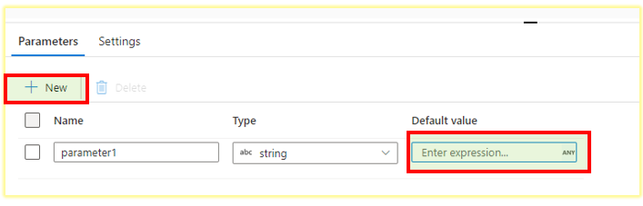

    I made use of the Parameter feature in the Data Flow.

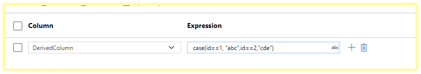

    I had a derived column similar in the question.
    Now at the dataflow level :
    I created a new parameter

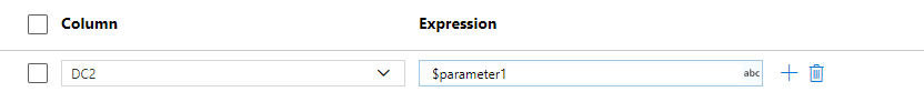

    In a Derive Column Transformation. I made the below mapping
    Output :
    Hope this will helps. Please let us know if any further queries.
