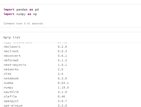

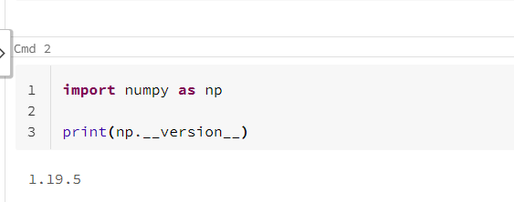

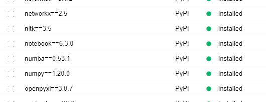

I have installed NumPy version 1.20.0 in my cluster by when I check the same in the cluster it's a different version 1.19.5. I have attached both the cluster and workspace screenshots. Also installing the packages in the cluster libraries takes more than 5 minutes but the scheduled job starts before the packages are installed, is there any way to speed up the package installation process or start the job after pkg installation.

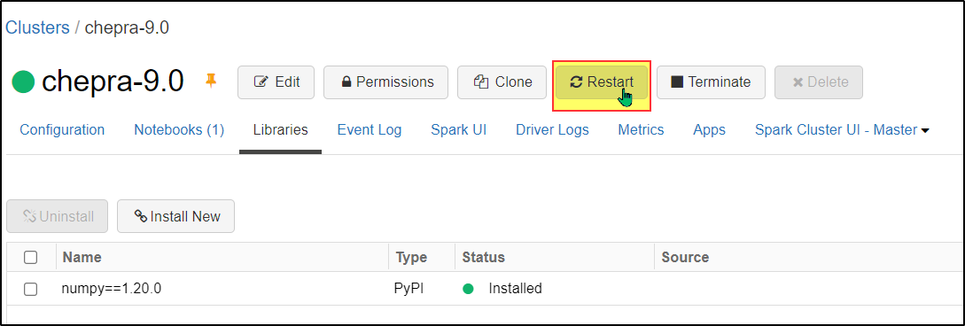

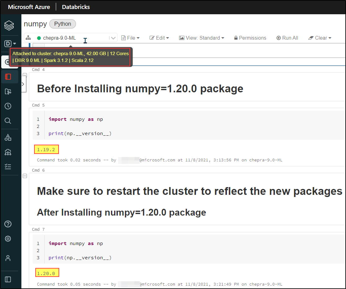

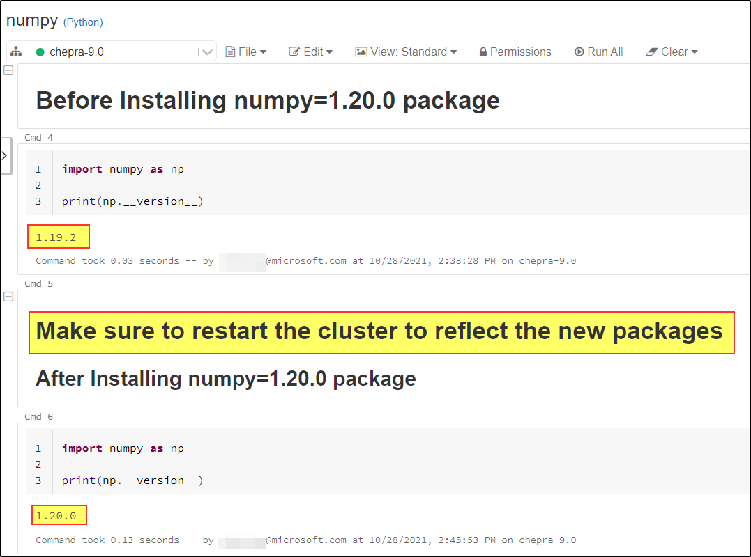

    Make sure to restart the cluster to reflect the new packages that you have installed.
    As per the repro, I had used numpy==1.20.0 package installation. By default it comes with 1.19.2 version and after installing 1.20.0 version you need to restart the cluster to reflect the newer package versions.
