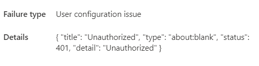

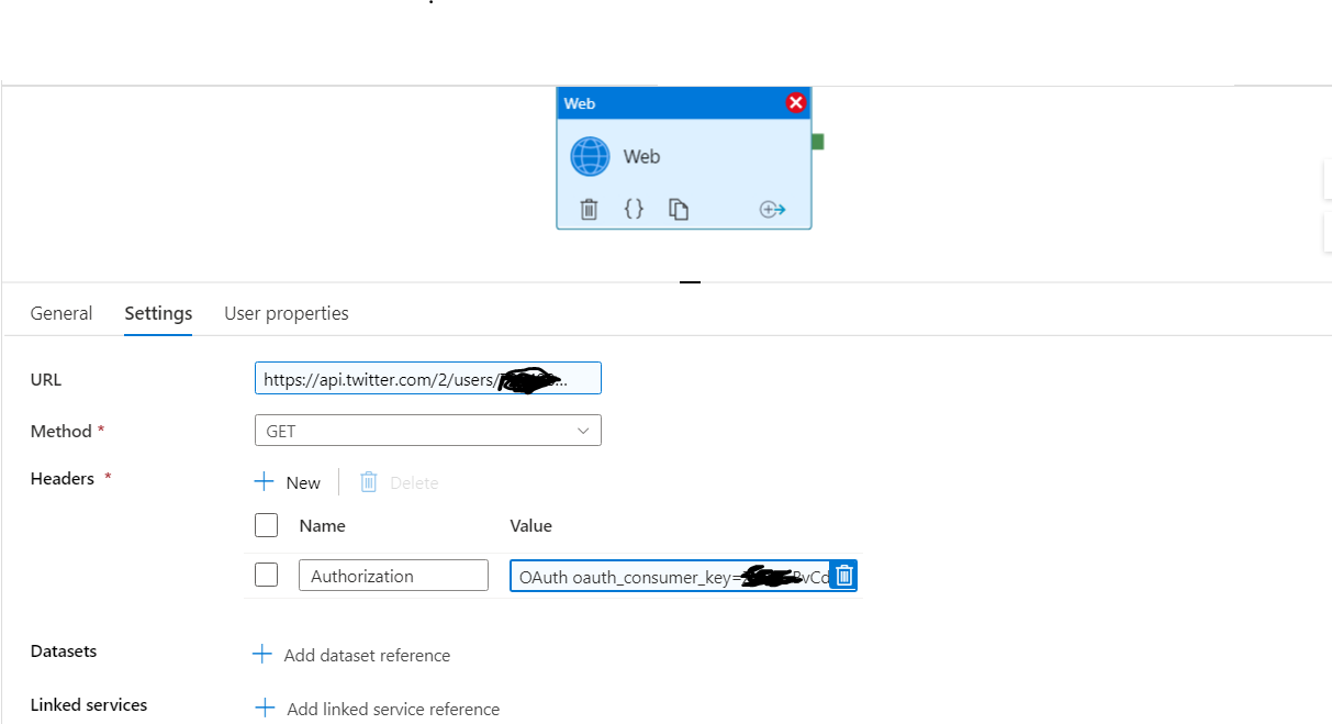

  2. Sachin 26 Reputation points
    2021-11-14T18:04:59.46+00:00
    @svijay-MSFT ... I am able to generate the oAuth signature and oauth nounce in power shell. Now When I used all the credentials in the Web Activity header, I am still not able to get authorize the endpoint
    PFA, the web activity Authorization header and the credentials149059-webactivity-adf.png149049-webactivity-error.png which I sent
    OAuth oauth_consumer_key=XXX&
    oauth_token=XXXX&
    oauth_consumer_secret=XXX&
    oauth_token_secret=XXX&
    oauth_signature_method=HMAC-SHA1&
    oauth_timestamp=1636911760&
    oauth_nonce=5t1Ev81dDKW&
    oauth_version=1.0&
    oauth_signature=XXXX%3D
    Please guide me what I am doing wrong here.
