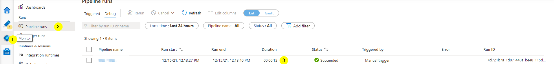

I have a set of ADF Pipelines to run in parallel.
Before the start of pipelines execution and end of the pipelines execution, Need to capture start time and end time and log (eg. write to a file).
Basically to calculate how much time duration is taking to run the set of pipelines.
Can anyone provide suggestions the best way/process to capture the timestamps?
Azure Data Factory
Azure Data Factory
11,624 questions
  1. HimanshuSinha-msft 19,486 Reputation points Microsoft Employee Moderator
    2021-12-15T21:13:33.827+00:00
    Hello @Krishna Bharat Yedla ,
    Thanks for the ask and using Microsoft Q&A platform .
    There are couple of ways by which we can do that . From the UI , you can check it as shown in the below screenshot

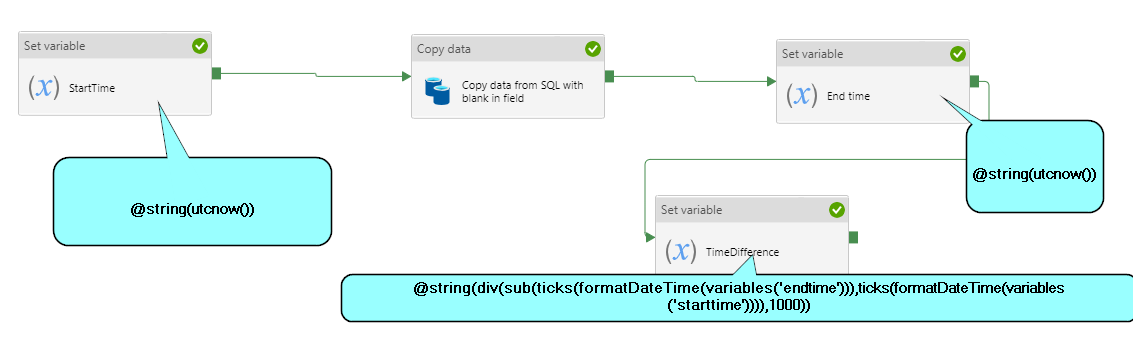

    In case if you want to capture the time within the pipeline you can do that also as shown in the screenshot below . At this time we do not have a function whcih gives the difference in dates , so we cab use the ticks function . The output can in nanoseconds but then you can use the div function and chanhe this in any time unit you want .
    Dynamic expression for time in millisecond
    @ hide (div(sub(ticks(formatDateTime(variables('endtime'))),ticks(formatDateTime(variables('starttime')))),1000))
    Please do let me know how it goes .
