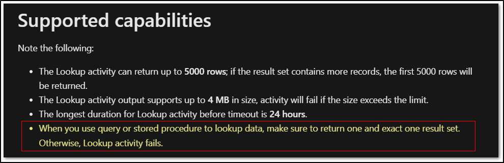

    But as per your requirement, in order to just update the DB2 records, I would recommend you to use Lookup activity in ADF which would help achieve your requirement. Please make sure that your query returns one and exact one result set. Otherwise, Lookup activity fails. Lookup activity expects a response from the query executed.
    Below are the supported capabilities of Lookup activity:
    Hope this info helps. Do let us know if you have further query.
