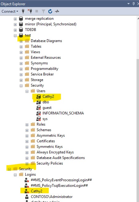

    1. Disable login Cathy2
    2... Disable database user Cathy2 mapped to the login Cathy2
    Refer to the blog How to disable a database user .

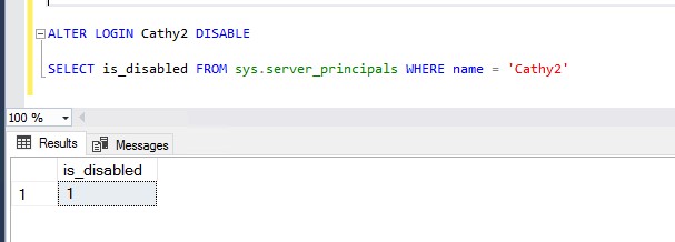

    To see it a login is disabled, run:
    SELECT is_disabled FROM sys.server_principals WHERE name = 'thename'
    If this returns 0, run
    ALTER LOGIN thename DISABLE
    I tried to disable from the UI on SSMS 18.10, and that seemed to work. (But I much prefer to work with SQL commands.)
