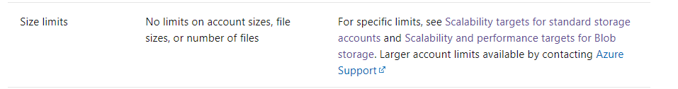

    1.Historical data would be maintained in a blob , and when data state grows exponentially in to TBs the Blob might not able to fit in.
    I am not sure if you have read the article https://learn.microsoft.com/en-us/azure/data-lake-store/data-lake-store-comparison-with-blob-storage as per this you can have 5 PiB of standard storage which can be further extended .
