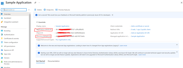

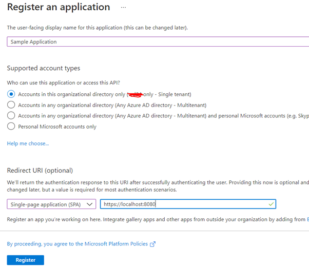

    To register the application in Azure Active Directory,
    Sign into the Azure portal and select Azure Active Directory in the tenant where you want to register the application.
    Under Manage, select App registrations > New registration.

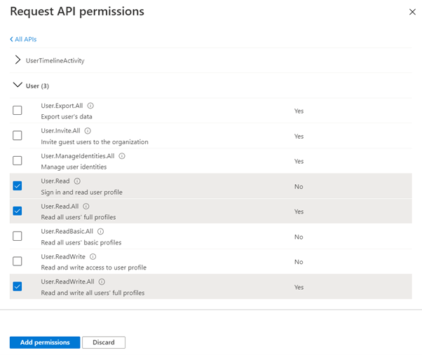

    The user or administrator must grant it the correct permissions via a consent process to access the application.
    Update the below applicationID, tenantID and redirect URI information in the application registered in Azure Active Directory.
