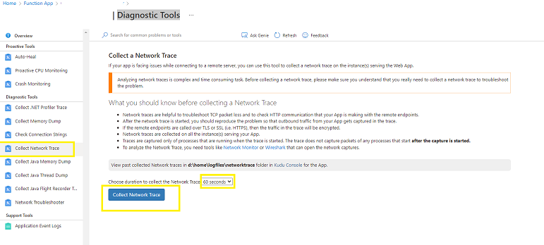

    @Asiful Nobel Thanks for clarifying. In that case, you can use the Diagnose and solve problems option on your function app blade.
    Diagnose and solve problems --> Diagnostic Tools --> Collect Network Trace --> Choose duration to collect the Network Trac and then click on "Collect on Network Trace"
