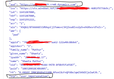

    The scope defined in the MSAL application is not matching the audience of the Dynamics CRM/Data verse.
    The audience “aud” claim in a Access token is meant to refer to the Resource Servers that should accept the token. When a recipient is validating the JWT , it validate that the token was intended to be used for its purposes, it MUST determine what value in aud and the token should only validate if the recipient's declared ID or URL is present in the aud claim.
    You can validate the access token you are getting through using jwt.ms.
    I have replicated the scenario in my lab , and I am able to get access token using ResourceOwnerPasswordCredential (Username Password) flow with right audience and able to call Dynamics CRM successfully.
    With valid scope and audience in the access token, I can call the Dynamic CRM API successfully.
    In your scenario the scope you mentioned in the application "https://admin.services.crm.dynamics.com/" is not matching with the audience of Dynamic CRM API and not allowing your application to access the API.
    Please update the scope of your MSAL application with the "https://[my domain].crm.dynamics.com/" as you mentioned in ADAL application
    var resource = 'https://[my domain].crm.dynamics.com/' for successful API call.
