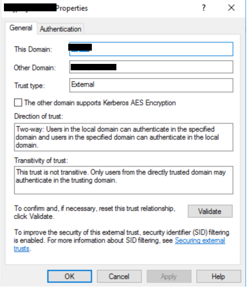

  2. Andreas 1,331 Reputation points
    2022-02-20T10:36:58.897+00:00
    Thanks for reply.
    Not sure what to look for, but I know we have a trust against DOMAIN-C but not against DOMAIN-B.
    DC3 was just added some weeks ago, do the other domain (DOMAIN-C) needs to do something or is this trust ok?
    On DC1 and DC2 I have the following image, and as you can see on DC3 the option for Kerberose is grey, why is that ?
    (DC1 and DC2)
    (DC3)
