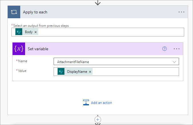

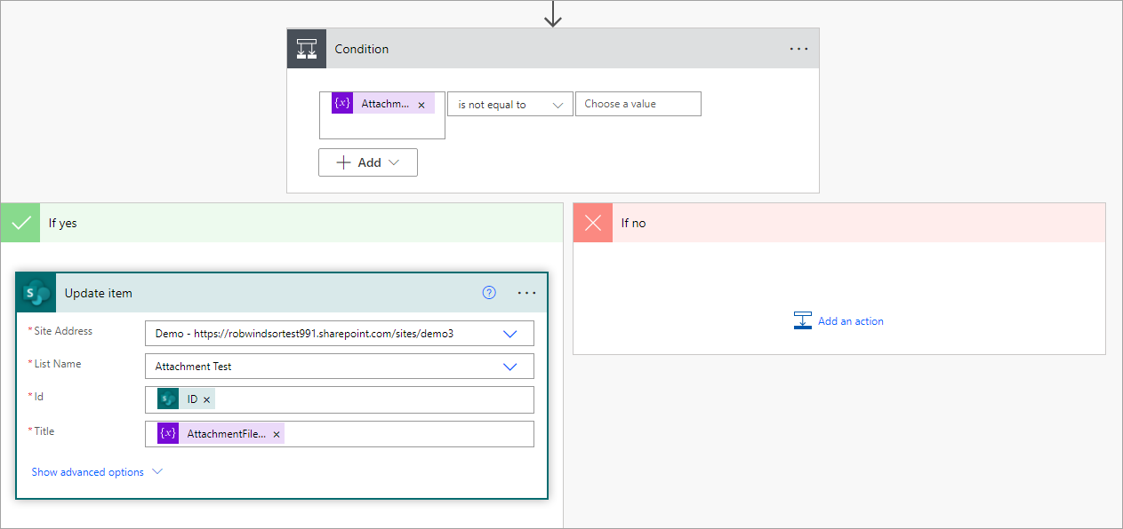

    You mentioned JSON column formatting, so I'm going to assume you are using SharePoint Online. if that's the case then I would suggest using Power Automate.
    You would use the When an item is created trigger, get the attachments, loop through the attachments (SharePoint enables you to add more than one) to get the name of the last attachment, and then update the Title field value if there was an attachment.

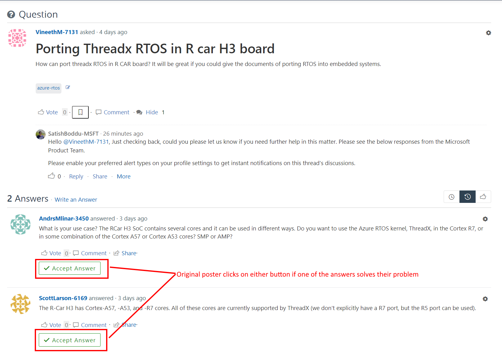

    Sorry for the late response, but I still not able to see any "accept answer" button. I really would like to accept it and give you all the credit for your help on this.
    The same thing just happened on another question I asked yesterday. I can't see any "accept answer".

    Finally! Both of my accounts merged!
    So, I was able to accept your answer. It was really because of my company account permissions I wasn't able to accept it.
