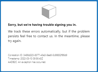

We're using SAML based B2C application that uses custom policies with our own customized HTML B2C Login Pages.
The problem we get user could login to our application both from Mobile Browser OR PC Desktop Browser. If they don't sign out OR the browser window is closed unexpectedly when user attempt to login next time, they get 401 Unauthorized error. This problem can be fixed by clearing Browser Cache, cookies, history and site settings.

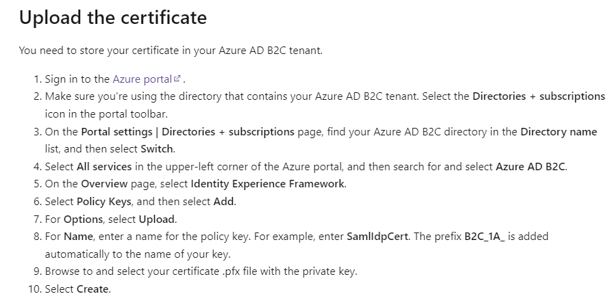

    Could you pls confirm you have followed the below steps to configure B2C_1A_SamlIdpCert? Thanks.
    Ref: https://learn.microsoft.com/en-us/azure/active-directory-b2c/saml-service-provider?tabs=windows&pivots=b2c-custom-policy#upload-the-certificate
