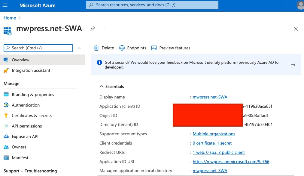

  1. Registered Azure Static Web App and Xamarin.Forms iOS/Android app in AAD B2C (directory: 'Mental Wealth Press'). NOTE: Azure Static Web app has ADB2C app ID ending in '85f' (Azure DNS Zone: mwpress.net - DEFAULT directory)

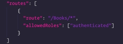

  2. Updated my SWA's staticwebapp.config.json to only allow authorized HTTPS requests to my 'Books' directory:
  3. Checked that my AD B2C app registration for my Azure Static Web app had authentication turned on (I successfully retrieve an access token via MSAL later):

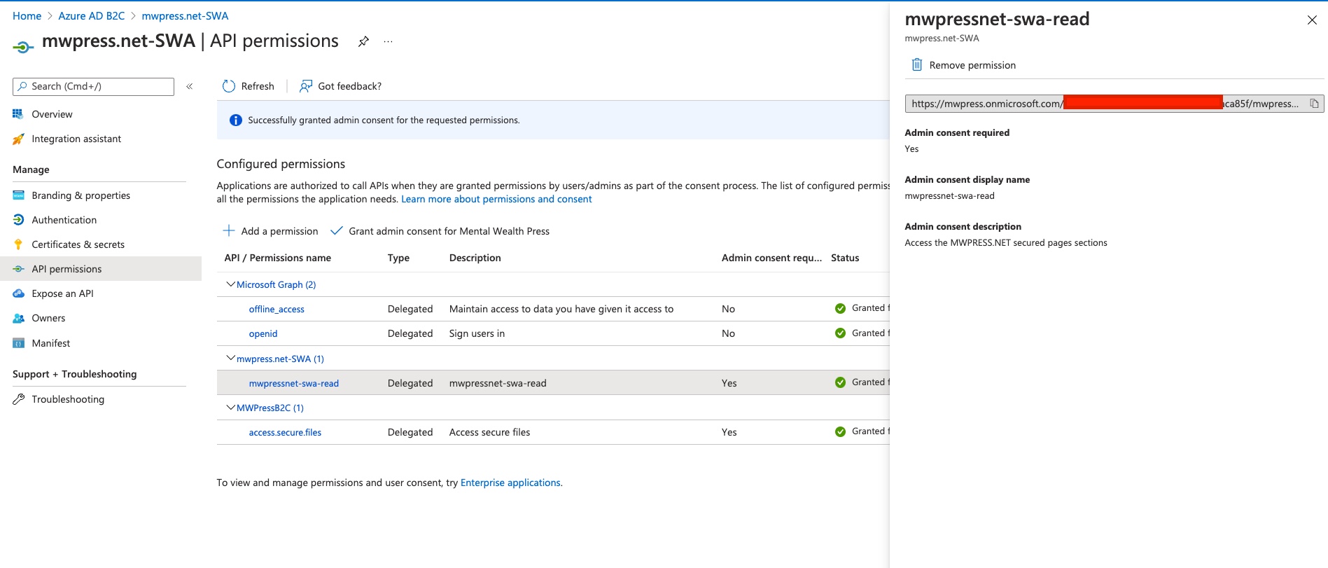

  5. Both of my AD B2C app registrations (SWA 85f and Xamarin forms 9fc5), have scopes set in AD B2C:

    I see that you have added mwprssnet-swa-read scope to the app registration and granted admin consent. The same scope is added to the scopes array within your configuration file and is returned in the access token as well. Now, when you pass this Access Token as a bearer in the authorization header of your API call, does the API perform the authorization based on the scope present in the Access Token? I suspect you are getting the 401 error because the authorization logic is not properly implemented within your API code.

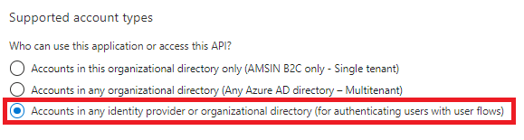

    The error AADB2C90068 error that you get when you use the App ID ending with a85f is because the application is registered as multi-tenant application which cannot be used with user flows. The application must be registered by selecting the below-highlighted option to use with B2C user flows:
