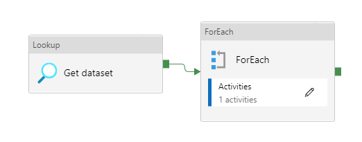

I'm working with Azure Data Factory v2, using a Lookup task against an Azure SQL DB which returns a set of results with two columns from a table (table1 in this example)
In this case the lookup returns these two columns:
OrderKey - This is the unique key reference of a particular order
JSON - This is a JSON payload that has been created by a previous task in another pipeline.
In testing, I'm only using ~800 rows but in production it will likely be over 100k rows.
Both of these columns are then used in the ForEach loop.
Inside the ForEach loop we use the JSON to send to a determined web endpoint, return the result and update table1 with the response for that OrderKey.

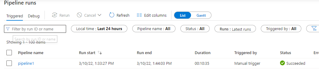

The web request should take no more than 5-6 seconds to return which is the case in the first few loops, the update to the table should also be quick and takes 5-6 seconds as well. In reality this ADF being slow, with TSQL we can perform this action quicker but we need ADF to get the result of the web request.
The process works, and is very fast in the first few loops.
After that, it seems to take an incredibly long time to actually perform the actions inside the foreach loop; particularly towards the end of the loop when there are less than 20 records left to process. When this happens each loop takes upwards of 3 minutes so the end result is the total pipeline takes far longer than it should..

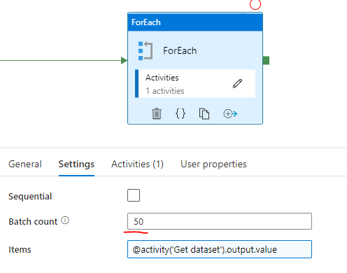

  • Change the batch size of the ForEach to 50, this results in the same performance problem

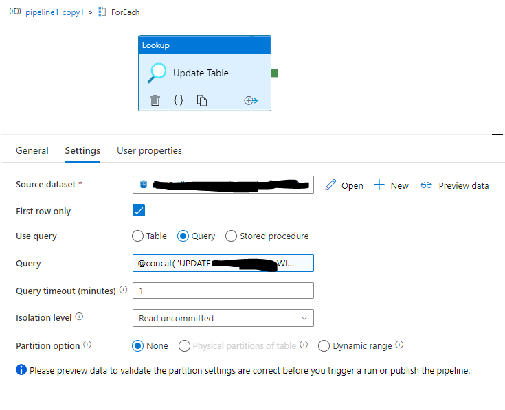

  • Changing the timeout of the lookup tasks performing the SQL DB table update to 10 seconds and the Query Timeout to 1 minute (as low as it will go) with retries enabled. This has proven some strange behaviour - often I'll see the the lookup doing the update task sit there for several minutes without doing anything.
  • Change the isolation level on the lookup task to ReadUncommitted and using table hints WITH(UPDLOCK, READPAST, ROWLOCK), same performance problem.

The best performance I've had so far is 800 records being updated in about 10 minutes, I'd expect that to be significantly quicker - more like 2-3 minutes.

    As I went through the details, it seemed that the issue is not with IR or SQL DB versions. You are trying to run multiple DML queries- in this case Update queries at the same time as the lookup which is trying to update the table is within foreach. With the increase in the number of concurrent queries running in the database , it might have blocked the resource class and in turn one query is blocking other queries. Below is the image showing max concurrent queries allowed based on service tier.
    The approach I would like to suggest here is instead of lookup activity which you are using to update the table for each item at the same time , it's better to use
    • copy activity to copy the output content of Web request (the one which you are trying to update in the table) into a dummy/stage table. Keep it a truncate and reload table for every transaction. It will bring the required data all at once in your database.
    • Then, use stored procedure activity or Script activity to join this dummy table with your original table to update the needed fields based on the OrderKey.
    This will replace the massive parallel update queries with a one-time update and will enhance the performance.
