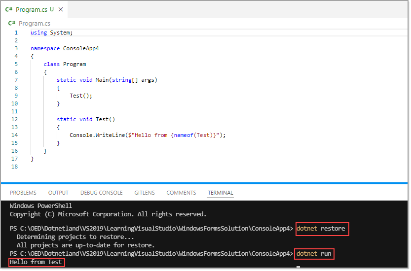

  1. Karen Payne MVP 35,596 Reputation points Volunteer Moderator
    2022-03-21T01:51:00.32+00:00
    Simply issue dotnet restore, dotnet run
