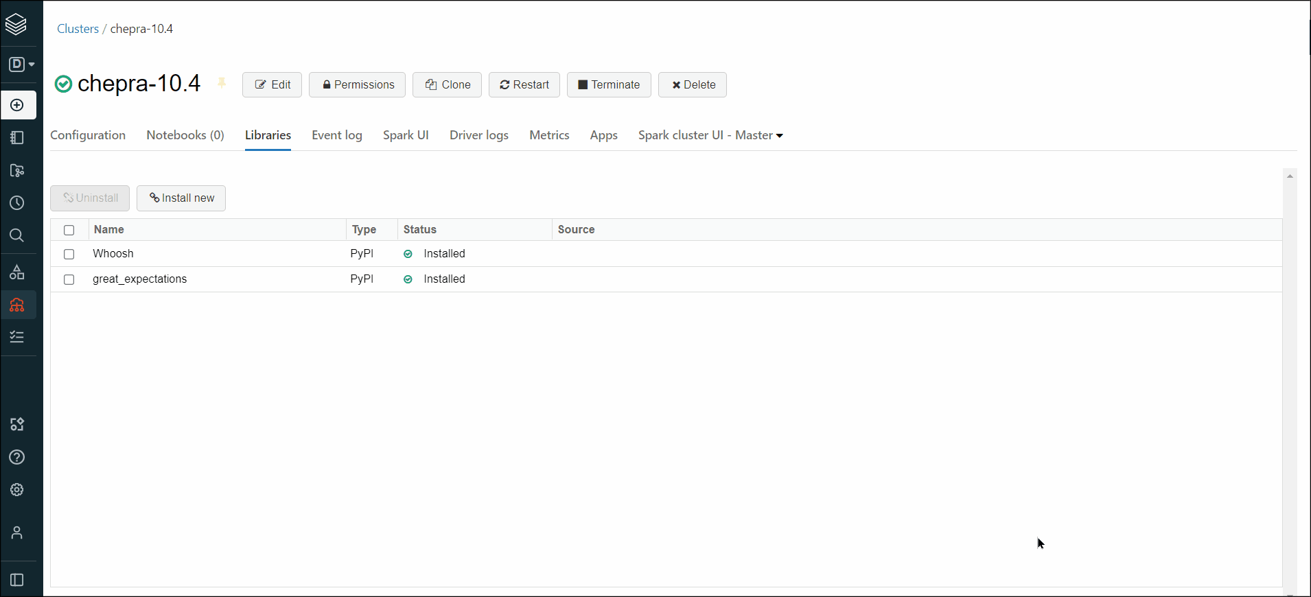

  1. PRADEEPCHEEKATLA 90,641 Reputation points Moderator
    2022-03-28T06:40:29.973+00:00
    Hello @Gopinath Rajee ,
    Thanks for the question and using MS Q&A platform.
    This could be an intermittent issue. I would suggest you re-try again and check if that works.
    As per the repro from my end, I'm able to successfully install the library named folium from the pypi org.
    Hope this will help. Please let us know if any further queries.
