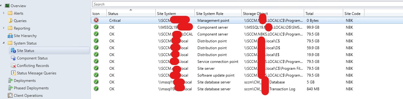

  3. Jason Sandys 31,421 Reputation points Microsoft Employee Moderator
    2020-08-28T14:28:03.797+00:00
    The top screen is perfectly normal and shows the client setup bootstrapper (ccmsetup) being successfully deployed to the system.
    The bottom screenshot shows an issue when the client is attempting to connect to the MP. The IIS server on that system is return a 404 (not found) error. That suggests your MP is not healthy. Have you reviewed the health of the MP in the console or the MP logs (including the MP setup logs) on the system indicated?
    From the MP log I don't see much...
