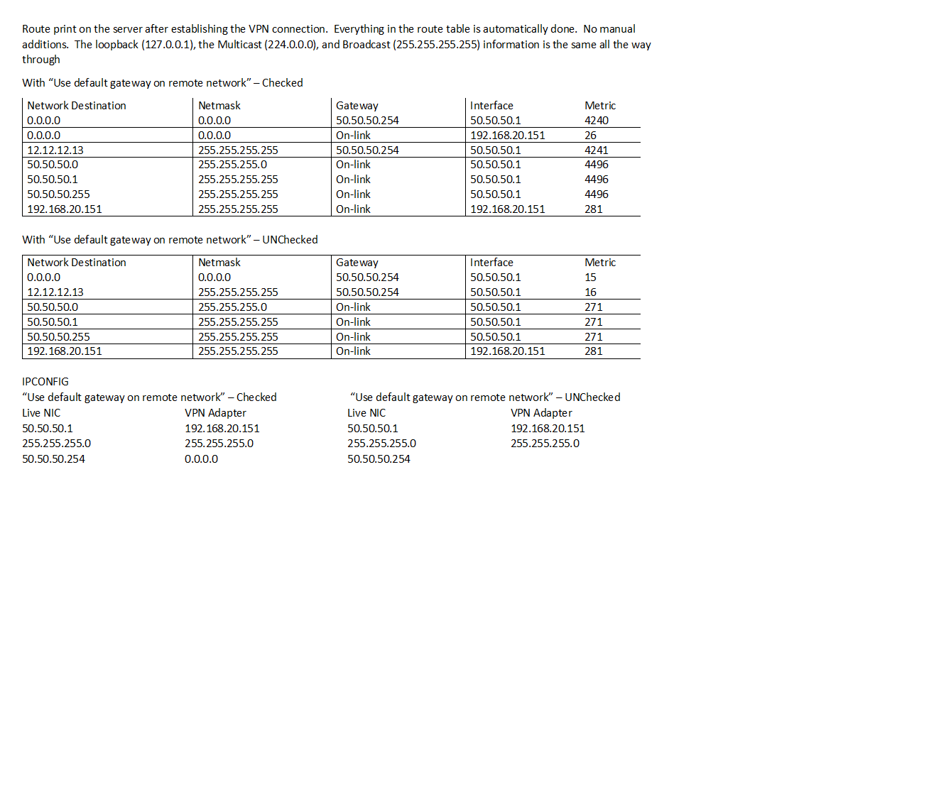

  5. Hai 1 Reputation point
    2022-04-24T01:40:32.823+00:00
    Route print on the server after establishing the VPN connection. Everything in the route table is automatically done. No manual additions. The loopback (127.0.0.1), the Multicast (224.0.0.0), and Broadcast (255.255.255.255) information is the same all the way through
    With “Use default gateway on remote network” – Checked
    Network Destination Netmask Gateway Interface Metric
    0.0.0.0 0.0.0.0 50.50.50.254 50.50.50.1 4240
    0.0.0.0 0.0.0.0 On-link 192.168.20.151 26
    12.12.12.13 255.255.255.255 50.50.50.254 50.50.50.1 4241
    50.50.50.0 255.255.255.0 On-link 50.50.50.1 4496
    50.50.50.1 255.255.255.255 On-link 50.50.50.1 4496
    50.50.50.255 255.255.255.255 On-link 50.50.50.1 4496
    192.168.20.151 255.255.255.255 On-link 192.168.20.151 281
    With “Use default gateway on remote network” – UNChecked
    0.0.0.0 0.0.0.0 50.50.50.254 50.50.50.1 15
    12.12.12.13 255.255.255.255 50.50.50.254 50.50.50.1 16
    50.50.50.0 255.255.255.0 On-link 50.50.50.1 271
    50.50.50.1 255.255.255.255 On-link 50.50.50.1 271
    50.50.50.255 255.255.255.255 On-link 50.50.50.1 271
    IPCONFIG
    “Use default gateway on remote network” – Checked “Use default gateway on remote network” – UNChecked
    Live NIC VPN Adapter Live NIC VPN Adapter
    50.50.50.1 192.168.20.151 50.50.50.1 192.168.20.151
    255.255.255.0 255.255.255.0 255.255.255.0 255.255.255.0
    50.50.50.254 0.0.0.0 50.50.50.254
