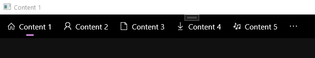

With ExtendsContentIntoTitleBar + SetTitleBar (on Windows 10, with a Manifest for >=Windows 8 compatibility)
See : Title bar customization
A test (on Windows 10 21H1):

Hi @Castorix31 can we change the titlename dynamically when we navigate to Pages in Winui3?
You can just change the title of the Window class (this.Title if you're inside the class)
For example, with a NavigationView and SelectionChanged event :
