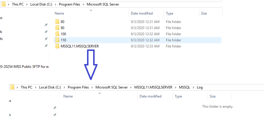

  4. Mabel Te 21 Reputation points
    2020-09-03T10:21:14.04+00:00
    Hi All,
    Following shows I do not have ERRORLOG. I have also search my C and D drive, but could not find any ERRORLOG also. For your kind advise. Thanks22481-errorlog.png
