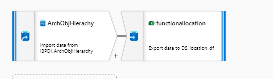

First I tried a DataFlow with first of all no transformations, only source and sink. With this I could process about 20 rows per second or about 80k rows per hour. After that I ran into a connection reset error.

In my case I need a few data transformations, but also e.g. Conditions before the data is transferred to Dataverse. Therefore I would prefer the way over the dataflows.
How does this performance difference come about if I use the same connector? Is there anything I can do to improve the performance in the dataflow? In the CopyActivity I still had settings like BatchSize. In the DataFlow I do not have this option.

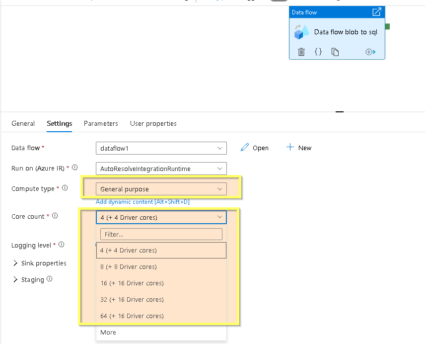

    I think you can definitely try to update the compute type & Core count and you should see performance benefits .
    Please do let me if you have any queries.
