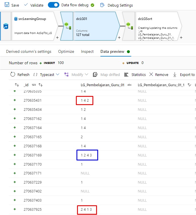

I have an input string that was delimited by white space. In the expression builder I try using expression language to split it. Splitting works fine as array output [] but issues come out when input string is not a sequence number (red box). So, I need to sort the array value but I don't know how to use it.
The ideal condition is
1 2 3 4
1 3 4
1 4
2 4
4
but sometimes input string is not sequential number.
1 4 2
1 2 4 3
3 4 1 2
anyone can help me how to use sort the array value ?
What am I confuse is
Sort expects a reference to two consecutive elements in the expression function as #item1 and #item2.
What I expect the output looks like these below:
input | output
1 4 2 | 1 2 4
1 2 4 3 | 1 2 3 4
3 4 1 2 | 1 2 3 4
anyone can give an example for me ?

    In order to achieve the above requirement, you can use below expression in your expression builder. This expression does split your input into an array and then sort the order and then replace the unwanted characters as needed.
    replace((replace((replace((toString(sort(split(input, ' '), compare(#item1, #item2)))), '","', ' ')),'["','')),'"]','')   -> Please note that `input` is the source column name in this sample
    Below is the output for the expression:
