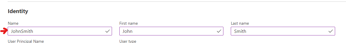

When I performed a Single Sign-On at my uniFLOW Online tenant, all the identities are claimed correctly except for username.
Instead of displaying John Smith, it was showing my email address.
Can you advise how should I configure the username attribute and claim in the new application (uniFLOW Online) so that the username displayed will be John Smith. Thanks.

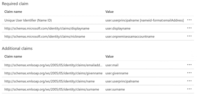

I attach screenshot of the settings in Attribute and claim for your persual.
The claim name I configured for username is http://schemas.xmlsoap.org/ws/2005/05/identity/claims/name

    As per the screenshot attached, the claim http://schemas.xmlsoap.org/ws/2005/05/identity/claims/name you are using to set username is mapped with user.userprincipalname which has email address value as shown below.

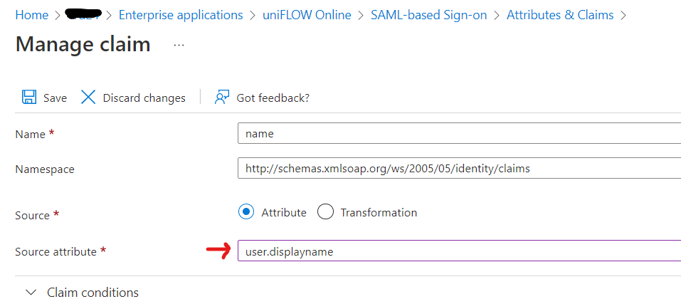

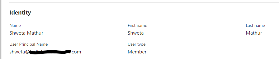

    To get the full name in the attribute, you need to edit the attribute mapping by clicking on Edit icon and change the attribute mapping to user.displayname. The display name maps the name as mentioned in user's profile and User Principal Name maps the unique email address of that user.

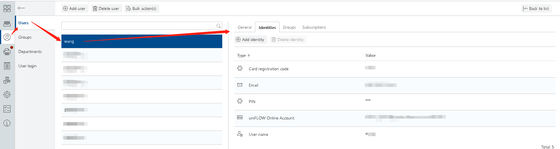

    By default, the printing system uses the computer's login name as the authentication user name.
    JohnSmith=print login=user1
    John Smith =user2
    In the user identities attribute of uniflow online, there is a user name, where the user name is equal to the computer's login name
    If no user name is set in identities, it will use the name displayname in general as the user name to display on the Canon MFP screen
