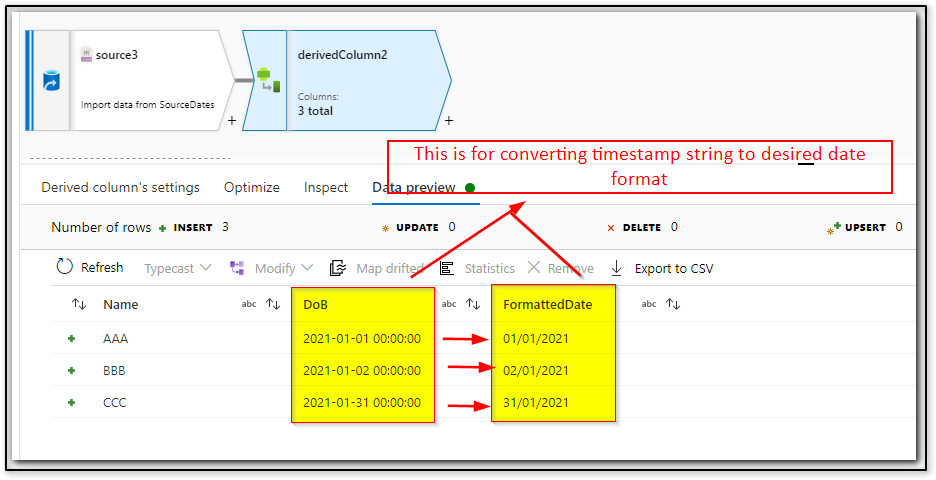

    You will have to use a combination of toString and toDate functions in your expression builder to first covert your source column string type into date type and then format as needed using toString as shown in below sample:
    **For example**: toString(toDate(DoB, 'dd-MM-yyyy'), 'dd/MM/yyyy')
    The above sample expression will result the below format:
    **Another example**: toString(toDate('2021-01-01 00:00:00', 'dd-MM-yyyy'), 'dd/MM/yyyy')
