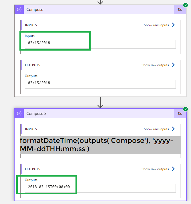

  2. Kamlesh Kumar 3,871 Reputation points
    2022-05-26T13:31:55.29+00:00
    Hi @Ananya Dixith ,
    Thank you for asking this question on the Microsoft Q&A Platform.
    Yes you are correct, this error is coming because of wrong DataTime format and you have to format it before passing to next step. Could you please check what input you are passing in Invoice Date, and then format it accordingly.
    Created a simple LA with below DateTime format,
    formatDateTime(outputs('Compose'), 'yyyy-MM-ddTHH:mm:ss')
    It will give you result like this, If you want the result in different format then please refer MS doc for more details,
    https://learn.microsoft.com/en-us/azure/logic-apps/workflow-definition-language-functions-reference#formatDateTime
