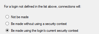

    Job process - scheduler => job sent to first production server A - calls out SSI package to link with second production server B for acknowledgment and response back. Communication issue when first production server A makes SQL call to database. (Error. SQLNCLI11 " for linked server "DB_Name" returned message "Client unable to establish connection"). Error reported back to scheduler.
    I hope that helps.
    Server A - SQL 2014 SP3, CUR and GDR
    Server B - SQL 2017, RTM, CU28
