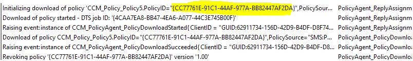

    Step 1: We could check Policyagent.log. When policy is received, the following entry is logged in PolicyAgent.log:
    We could check if Deployment Unique Id on the console is consistent with policy id displayed in PolicyAgent.log.
