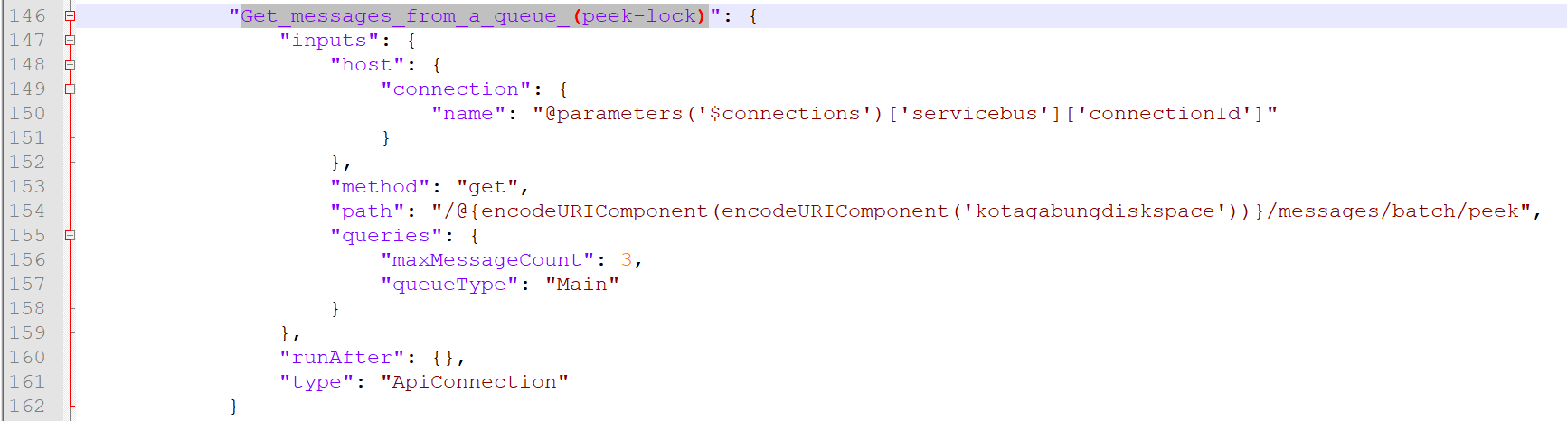

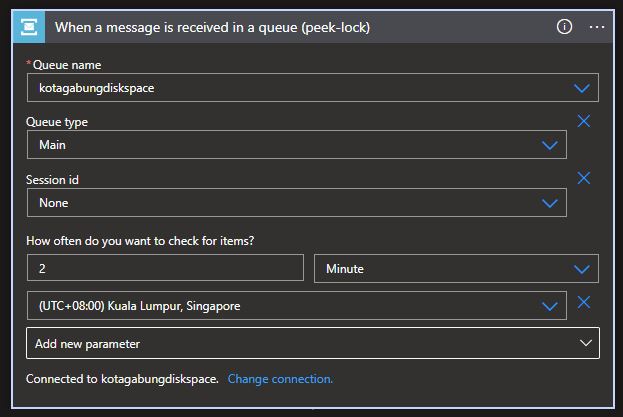

I am currently using Logic App and Service bus to develop an email notification feature upon some conditions are satisfied.
The architecture diagram is as follows and attached:
The Logic App will send out an email when some conditions are satisfied.

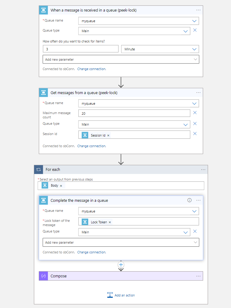

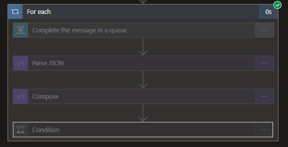

The Logic app sequence is as follows:

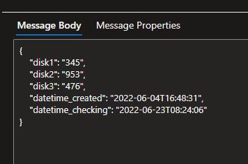

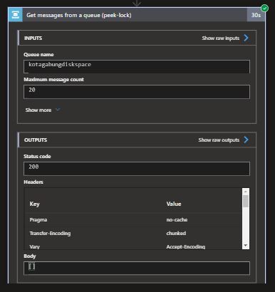

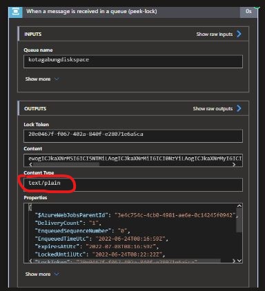

Based on the architecture, I think the Function App data processing and Service bus configuration is properly setup as I am able to view the message in peek mode in Azure Service Bus Explore portal:

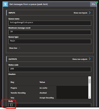

However, the message body in Logic App environment is empty [] when I was using "Get messages from a queue (peek-lock)" connector.

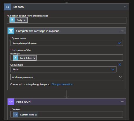

I am wondering if the logic app flow is not properly programmed.
From my knowledge, message queue generated by function app as output binding is peek-lock type by default.
I am also able to peek the message inside Service Bus Explorer, so that I use peek-lock connector in Logic App environment.
I attached the text file contains the logic app code view.
Thank you for the community help in advance!

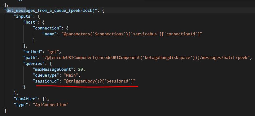

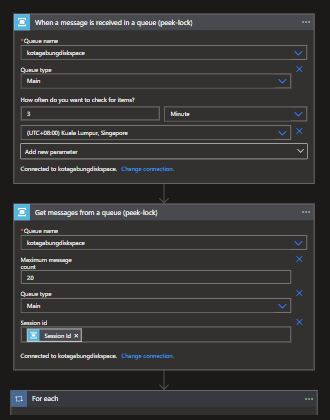

    You are getting empty value because of missing "SessionId" input,
                "Get_messages_from_a_queue_(peek-lock)": {
                    "inputs": {
                        "host": {
                            "connection": {
                                "name": "@parameters('$connections')['servicebus']['connectionId']"
                        "method": "get",
                        "path": "/@{encodeURIComponent(encodeURIComponent('testtopic'))}/messages/batch/peek",
                        "queries": {
                            "maxMessageCount": 20,
                            "queueType": "Main",
                            "sessionId": "@triggerBody()?['SessionId']"
                    "runAfter": {},
                    "type": "ApiConnection"

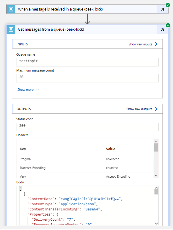

    I tried to replicate it at my end and it's working fine for me, please refer the above code,
