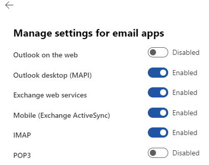

The account I used for testing, does not have 2FA enable and in the Exchange admin center, IMAP is enabled:

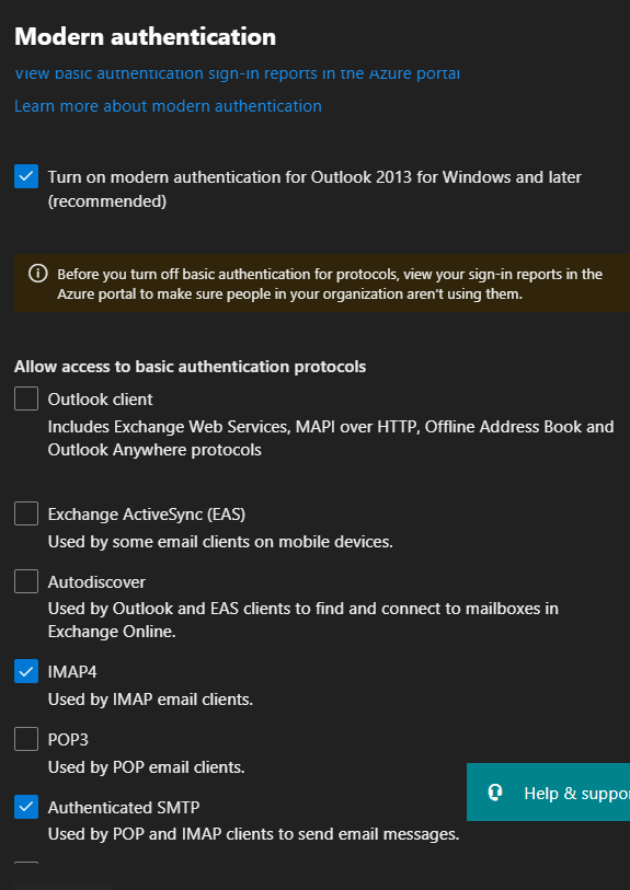

Also, In my Microsoft 365 admin center, under Settings->Org settings->Modern authentication, I have the following settings:

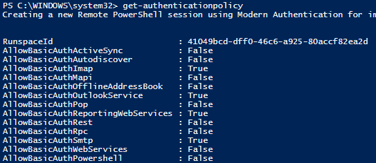

When I check the auth policy with Powershell, this is what I have:

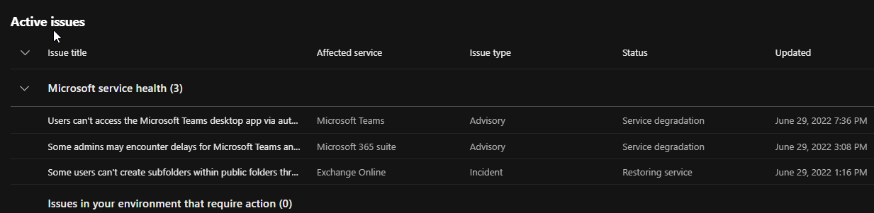

    I want to confirm with you that how many user have this issue? You could have a check in Service health from your Microsoft 365 admin center first. Check whether there exist issue with your tenant.

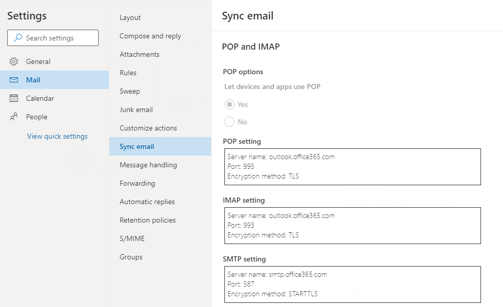

    Then try to enable OWA for this mailbox, login OWA and check whether those information below exist. You need configure IMAP account with information below:
