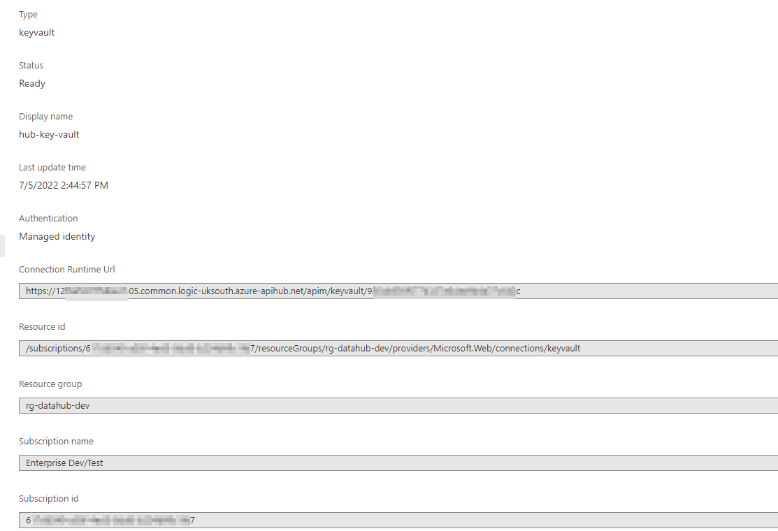

After deployment, the connection is showing as connected:
![217794-image.png]5

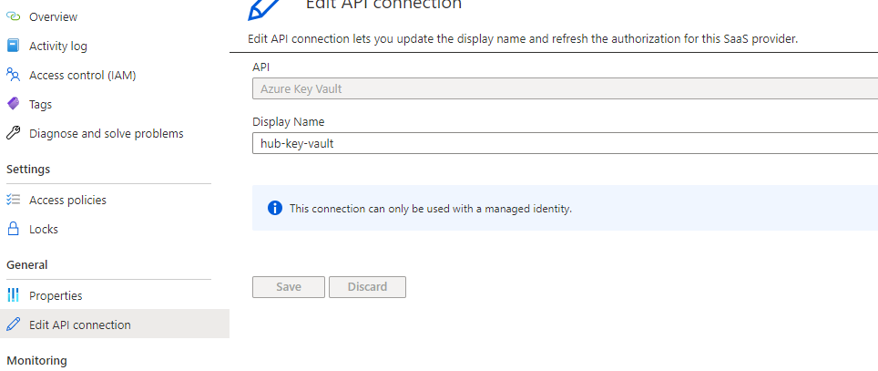

Any the authorisation correctly showing Managed Identity (again, the logic app has been granted access to the key vault & access policies in the KV):
However, in the designer despite showing a valid API connection, no secrets are listed:
When running a test of the workflow, the error generated refers to a missing access token.

    Kindly confirm if you have enable the access to Azure Resource Manager for template deployment, please refer the below screenshot to check and confirm.
    And check the setting in Networking tab as well, Is access allowed for all network or restricted to selected ?
    Finally please check the Connection Properties in connections.json file. If it is missing then add it.
