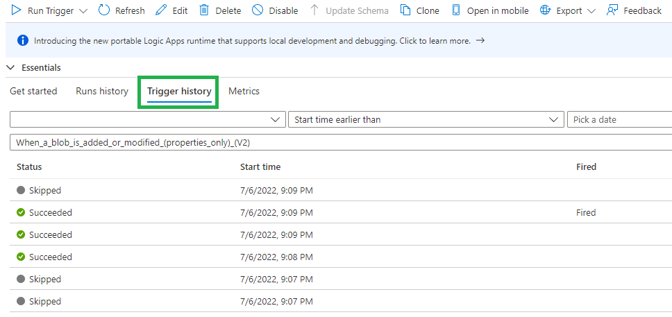

  1. MayankBargali-MSFT 70,936 Reputation points Moderator
    2022-07-14T02:14:40.913+00:00
