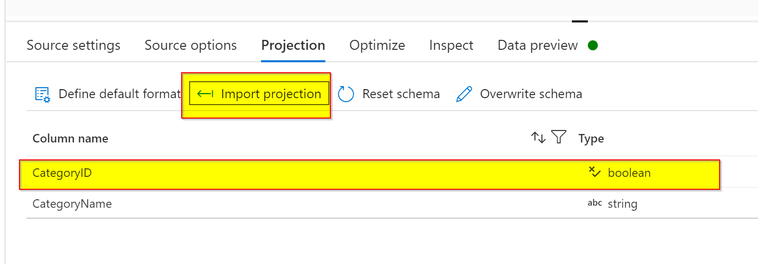

I have the following in JSON
"TypeId":1
And In data Factory Mapping its coming through as boolean (True flase) in the projection. And it should be an int

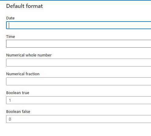

I can't find any way to change it to in in the source setting
But it made no difference. When I flatten in preview I get
How do I get past this issue? I need it to be integer not Boolean

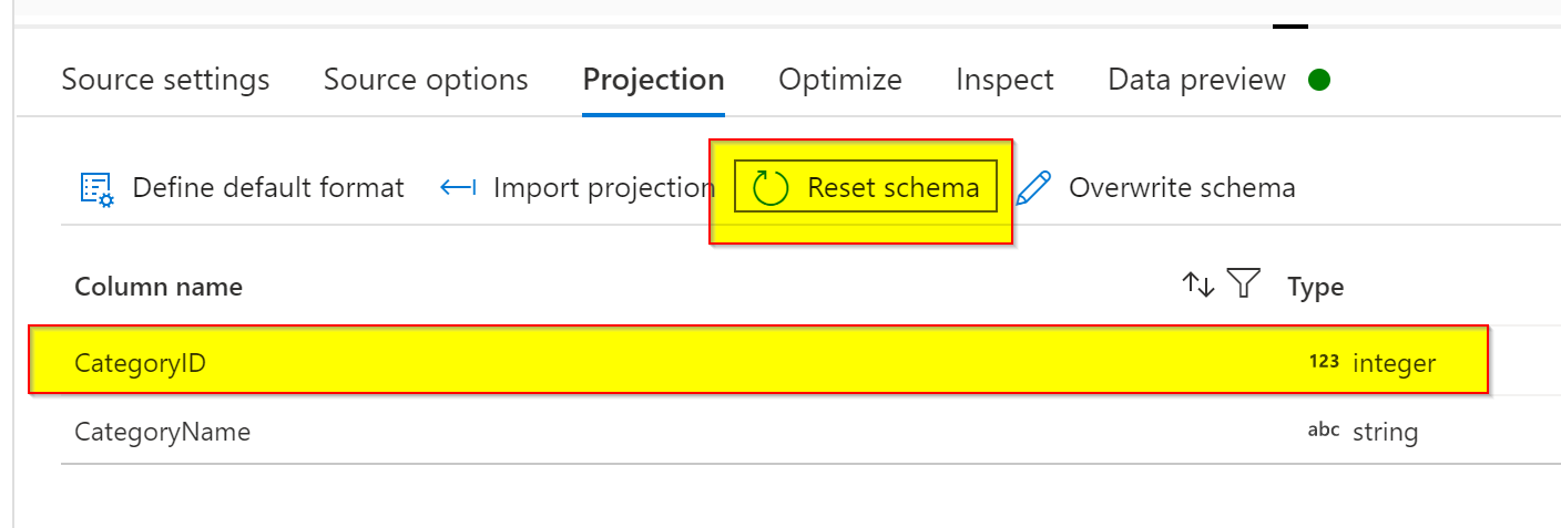

    • Then you can use reset schema which would set the boolean value to integer

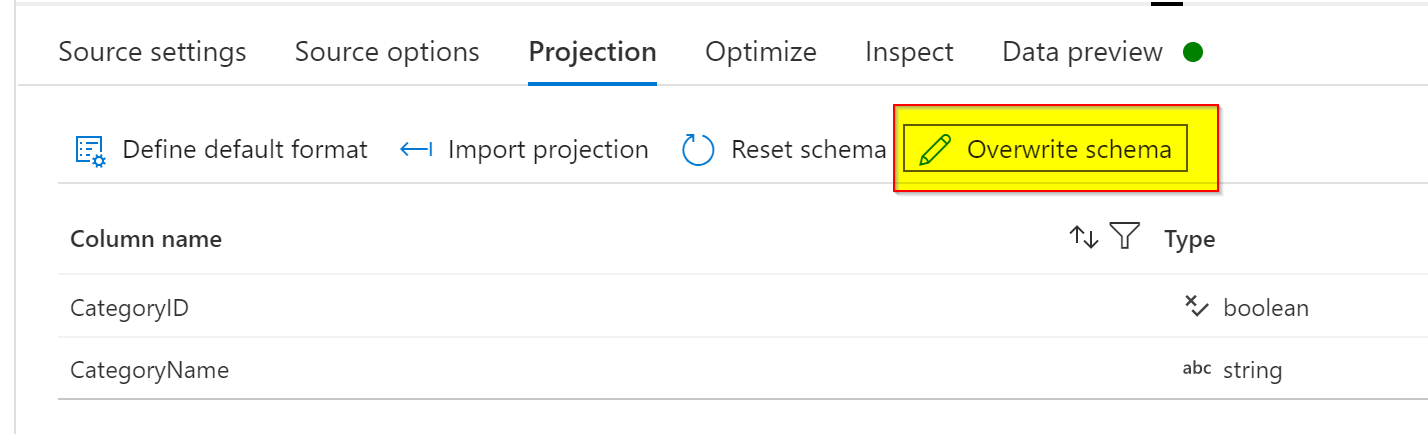

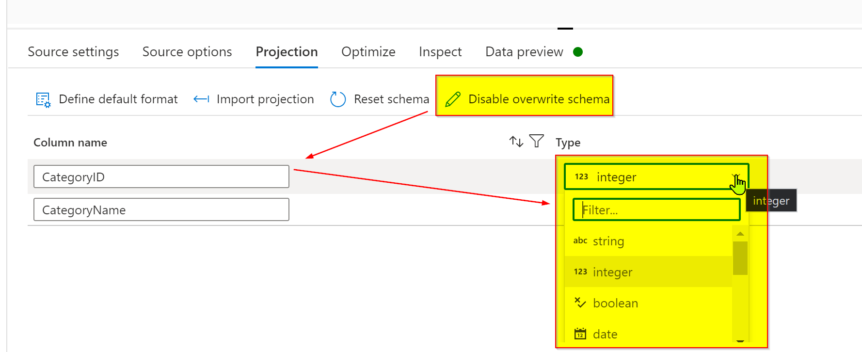

    • Another thing you can do is to click on overwrite schema option under projection tab of your source.
    Step 1:
    Option 1:
    Reset schema:
    Option 2:
    Overwrite schema:
    And then select integer data type for your column.
