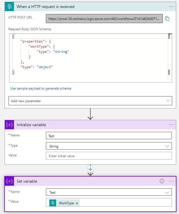

  1. Kamlesh Kumar 3,866 Reputation points
    2022-07-12T03:30:53.143+00:00
    Hi @hbaw ,
    Welcome to Microsoft Q&A Platform. Thank you for the question.
    I would suggest to initialize the variable and then set the variable like below screenshot. And you have the JSON schema so you can add the fields and can use for several values.
