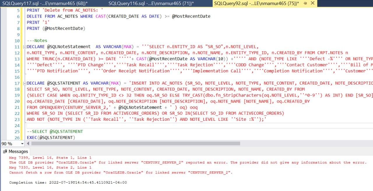

We recently migrated from one sql server to another. So all the workload, Tables, Jobs, Linked servers were migrated as well. But some Jobs are failing in the new server and working perfectly fine in the old server. One of the failing Jobs is a Job that fetches data from a Linked Server Oracle Oledb and inserts into our Tables. The Job has several steps and it fails in the first step after it does a couple of commands.

The OLE DB provider "OraOLEDB.Oracle" for linked server "LINKED_SERVER_NAME" reported an error. The provider did not give any information about the error. [SQLSTATE 42000] (Error 7399) Cannot fetch a row from OLE DB provider "OraOLEDB.Oracle" for linked server "CENTURY_SERVER". [SQLSTATE 42000] (Error 7330). The step failed.
So apparently the job is running fine up to this point "Delete from Table5 [SQLSTATE 01000] (Message 0) and then generates an error. " and then can not fetch data. The next step after Deleting from Table5 is Executing a @SQLStatement parameter that fetches from Linked server and inserts into one of the SQL tables.

  3. Noz Mamur 21 Reputation points
    2022-07-20T13:17:54.263+00:00
    • UPDATE So I tried running the queries in SSMS query window and it failed with the same exact error. I know there is no issue with the query. Then I tried to Select top 1000 and Insert INTO and it did in fact worked perfectly fine. With all the Case and Where conditions it inserted 84 rows into my SQL Table. But when tried to run the entire query again removing TOP 1000 it failed with this error again. I have no idea...
  4. Erland Sommarskog 121.9K Reputation points MVP Volunteer Moderator
    2022-07-21T07:59:00.94+00:00
    Seeing how the query looks like, I would suggest that you rewrite the operation to receive the data from OPENQUERY into a temp table, without any filtering against ACTIVECORE_ORDERS. Then insert into the AC_NOTES from temp table applying that filtering.
    Also, the filtering on NOTE_TYPE and NOTE_LEVEL is better to pushed inside OPENQUERY, so that is performed on the Oracle side, reducing the number of rows that are brought over.
