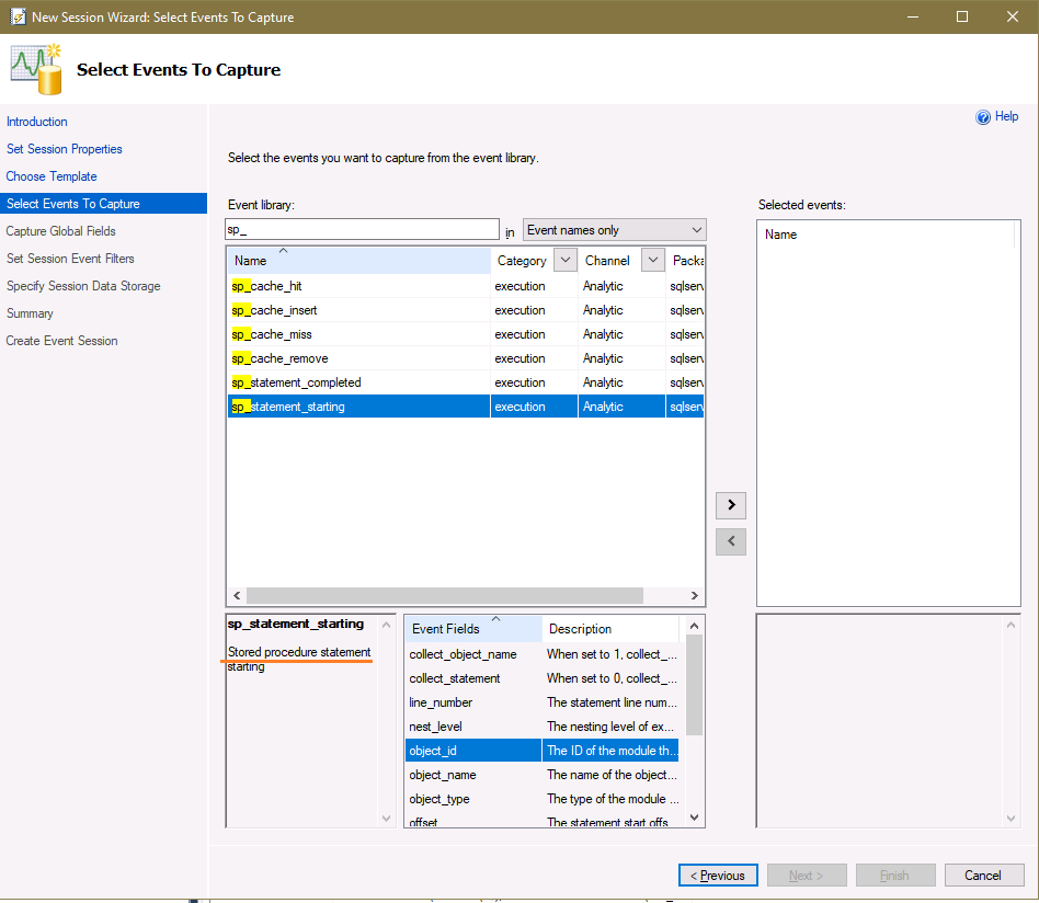

Hello!
The XE wizard "says" sp_statement_starting event should be logging the sp starting:
And it does log starting of SPs (object_type = PROC), but it also logs PREPARED events:
Q1) Why?
Q2) Can I get rid of them and see in the log ONLY starting of the stored procedures?

  1. Erland Sommarskog 121.9K Reputation points MVP Volunteer Moderator
    2022-07-26T11:55:17.947+00:00
    So how exactly did you run the procedure? Typed an EXEC statement in a query window, selected it, and pressed EXECUTE?
    It does not seem like that. Rather it seems that you used the Execute option from the context menu in Object Explorer. Whatever, these PREPARED queries are not from the execution of your stored procedure, but queries that SSMS ran behind your back. If you find the statement for your procedure, you will see that object_name has a value, and object_type is something else.
    As for PREPARED, there are some variations on that theme, and I think that X-Events is somewhat inaccurate here. A prepared in the true sense, is when a client API calls sp_prepare with query and gets back a handle, so it can execute the same query many times without sending the query text. But SSMS is not using this, but it does send the query text every time. It appears that X-Events just lumps everything which is not a stored procedure into PREPARED.
    2022-07-25T17:07:43.007+00:00
    sp_statement_starting is fired every time the execution of a stored procedure moves to the next statement.
    If all you want to see is when the procedure starts, you should collect the event module_start.
