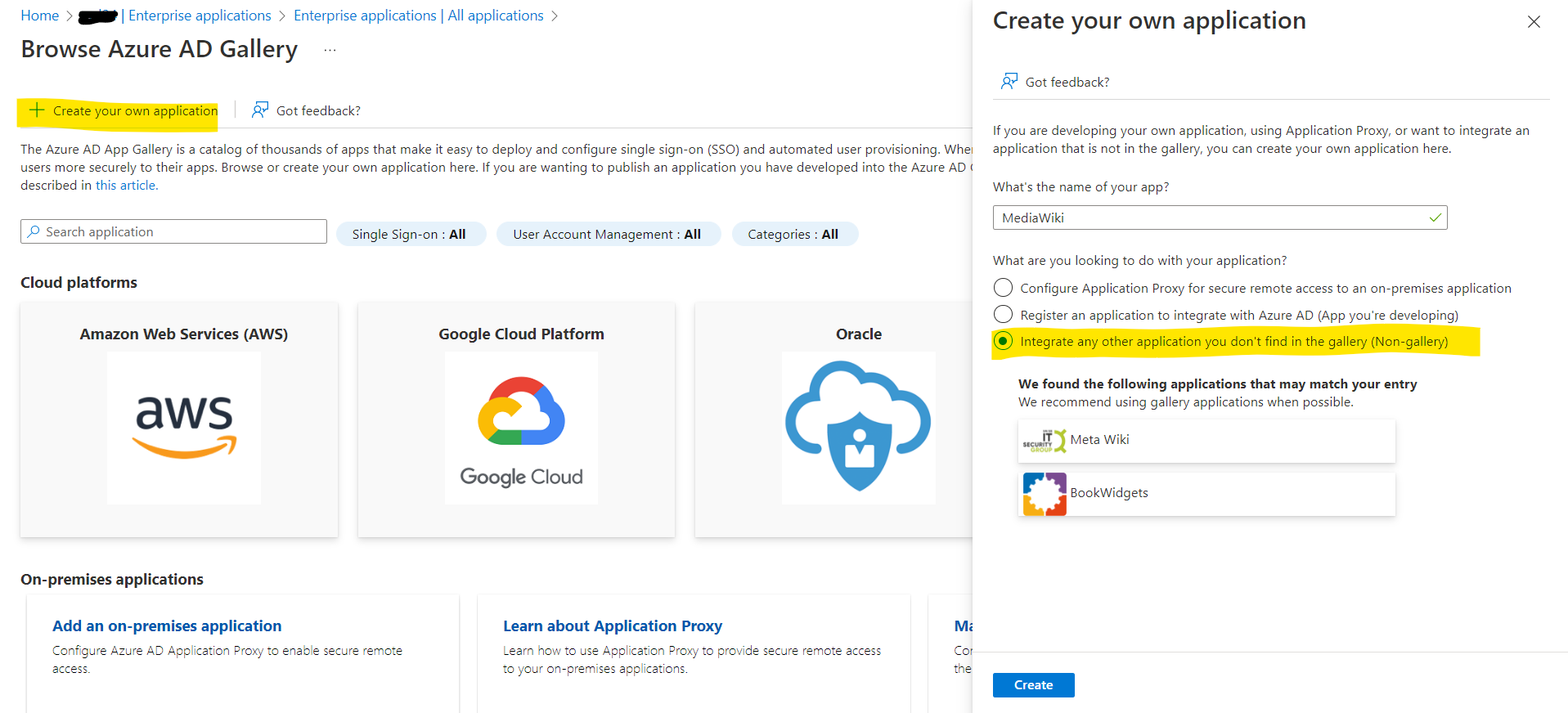

    I understand you are trying to configure single sign on in Azure AD for MediaWiki application to increase the lifetime of SAML token but getting the error "The single sign-on configuration is not available for this application in the Enterprise applications experience" although you are registering the application in Enterprise application.
    To understand, Application Registration and Enterprise Application
    App Registration are basically the apps local to the tenant/organization in which they have been registered to generate unique application id.
    Enterprise apps blade shows global apps which can be configured and used within your tenant/organization.
    Usually, Apps that are registered using the App Registration blade are considered to be apps that would use either OAuth or OpenIDConnect. Hence the SAML SSO configuration option is not present there.
    In case you have created a custom SAML app, that you want to integrate with Azure AD, you need to select the following option under Enterprise Registration: "Integrate any other application you don't find in the gallery"
    This setting will allow to setup the SSO for custom SAML application.
