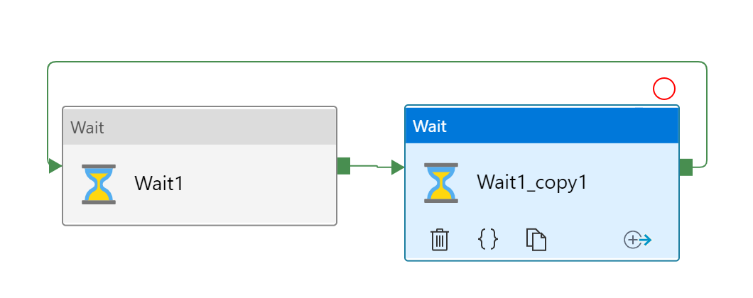

    A cycle is activities connected in such a way that it goes in a circle or loop. If you follow the connection lines, you eventually end up where you start. This is a cycle, like a wheel on a bicycle. Picture below
    The problem with this, is you could make an activity run more than once, and the pipeline would never end, continuing again and again. So, to protect both your wallet and our computers, we disallow such endless behavior. The validator checks for this sort of cycle, as well as execute pipeline trying to call itself, and variables assigning to itself.

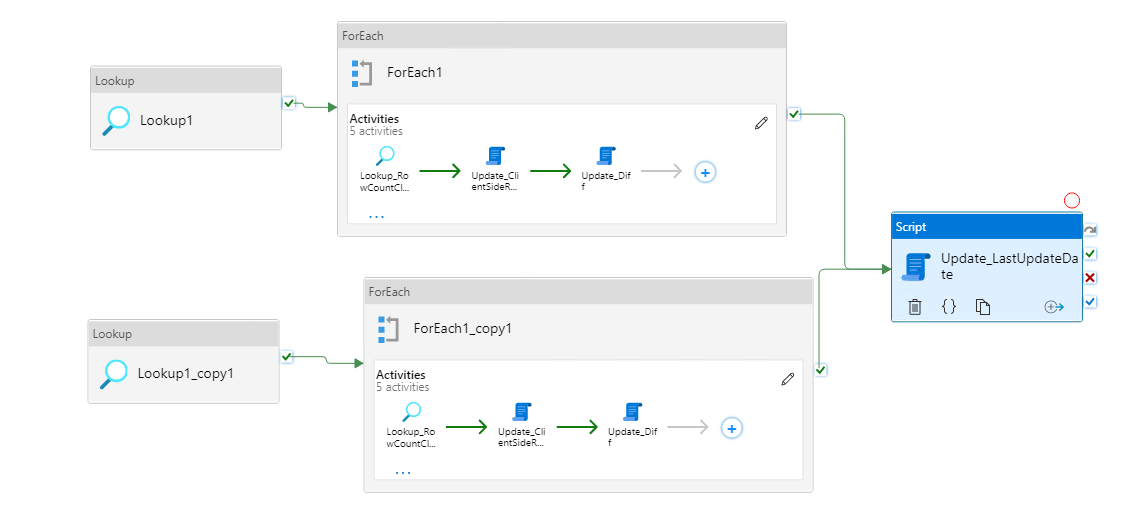

    This is what is in this particular pipeline. There are two foreaches, but it wouldn't create a loop. One foreach looks at rows with a certain criteria, the other diff criteria. If i remove the copy ForEach, then it validates. Another thing I've noticed, is I receive this error even if I clone then entire pipeline..though that may be something else.

    Ok, not sure why, but I duplicated the pipeline, made the same changes to add the second ForEach and now this one validates just fine...not exactly sure why. I looked at the JSON and they look identical. Not very helpful in determining, but maybe if others have a similar issue, try duplicating the pipeline without the changes, then make the changes in the new pipeline and see if it's just something odd in the original?!
